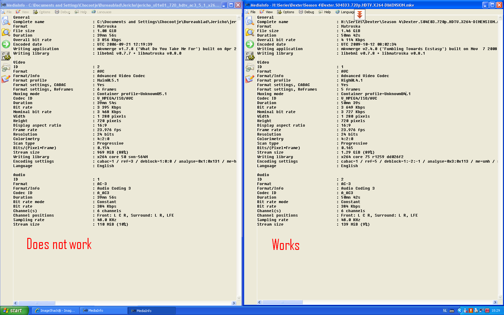

For some time now I have been trying to figure out how I can watch these files on my blu ray player.
I have the BD-P1600 blu ray player(latest firmware 2.04) and an external hard disk which is formatted as ntfs.
I downloaded 3 mkv files but I can only watch 1 of those. For the other 2 files my player says ''Can't read this format''.
The problem is that I have no clue what the difference between these files are and why it plays this one file but doesn't play the other two.
I downloaded the program MediaInfo and uploaded a picture of 2 mkv files.
My blu ray player does read the Dexter file but it can't read the Jericho file.
I hope someone has an explanation for it and knows what I am supposed to do to watch all my mkv files.

Oh, sorry, I misread your original post. Your TV can read the drive and play some of the MKV files but not one in particular.
Which of the two files in the BMP file is the one that doesn't play? The one on the left? It's probably the 5.1 profile. I believe most hardware players are limited to 4.1 or 4.2. -
Yes, it's the one on the left. Is there a program where I can change the format profile with?

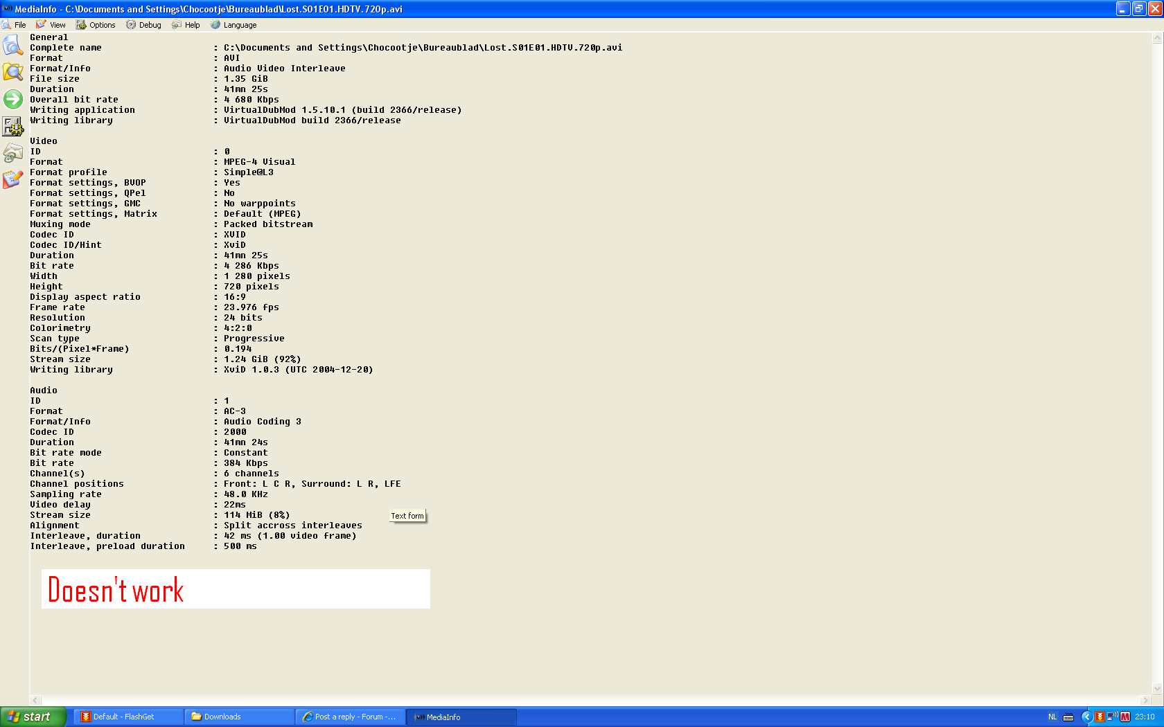

My third file however has format profile; simple@l3 and doesn't play either.

LOL. I just noticed the big red "does not work" at the bottom of your image. Check the number of reference frames "ReFrames" on the l3 profile file. There may also be a problem with the number of consecutive b-frames but I don't think MediaInfo shows that.
I believe it's possible to change the profile that's flagged in the h.264 headers. That doesn't change the actual encoded video properties but may be enough to get the TV to play the video (with occasional problems). I don't know what program does this though. Otherwise you'll have to reencode the video with appropriate settings.
h.264 has a lot of encoding features that most playback hardware does not support. Unfortunately, many people just crank up all the settings thinking it will make their videos better. -
Hehe, I edited the picture so you couldn't have seen it in the first place :P.
The third file apparently is a bit different, it's format is MPEG-4 and it doesn't show reframes in mediainfo.

I don't see anything that sticks out in that Xvid AVI file. Since your player plays h.264 MKV with 1280x720 frame sizes it probably also plays Xvid AVI at that frame size. It doesn't have the Xvid features that usually cause problems: GMC and QPEL. There is one feature that might be a problem but MediaInfo doesn't report it: packed bitstream. You can open that file in Mpeg4Modifier and chang it from packed bitstream to not (or vice versa) and see if that makes any difference. You can also try remuxing into an MKV container with MkvMergeGUI.
