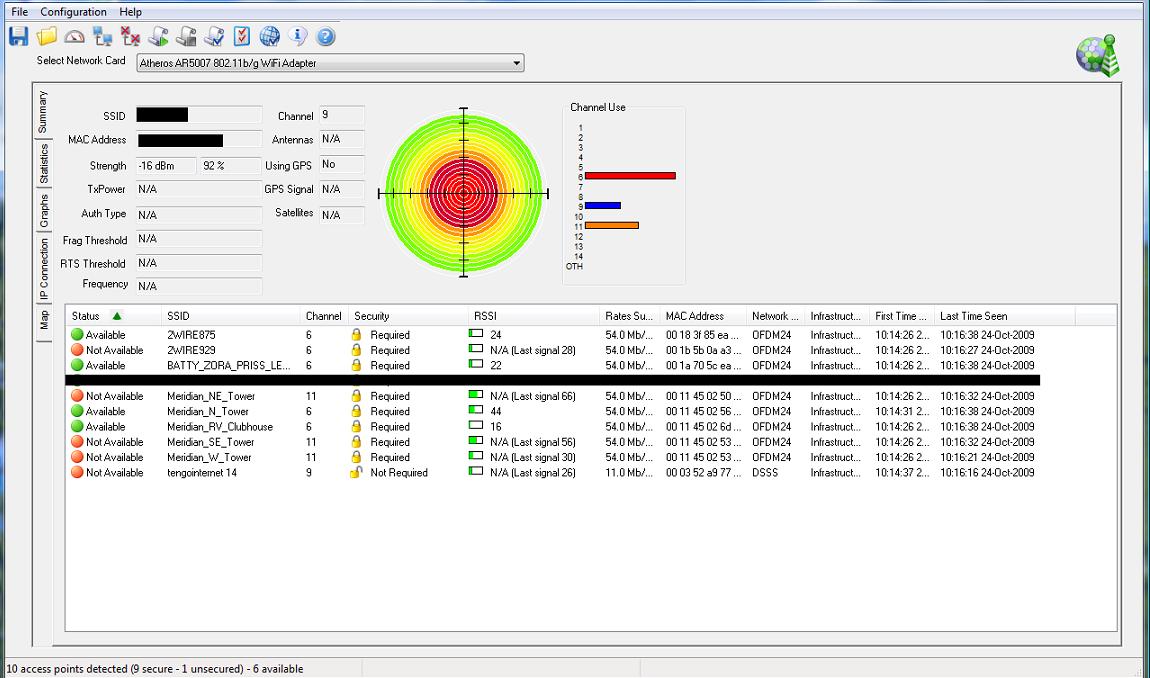

    I've used WirelessMon to check out the signals in my neighborhood. It has a 30 day trial. http://www.passmark.com/products/wirelessmonitor.htm

    Here's what my local area looks like at present. The Meridian names are the ISP's WiFi transceivers:
