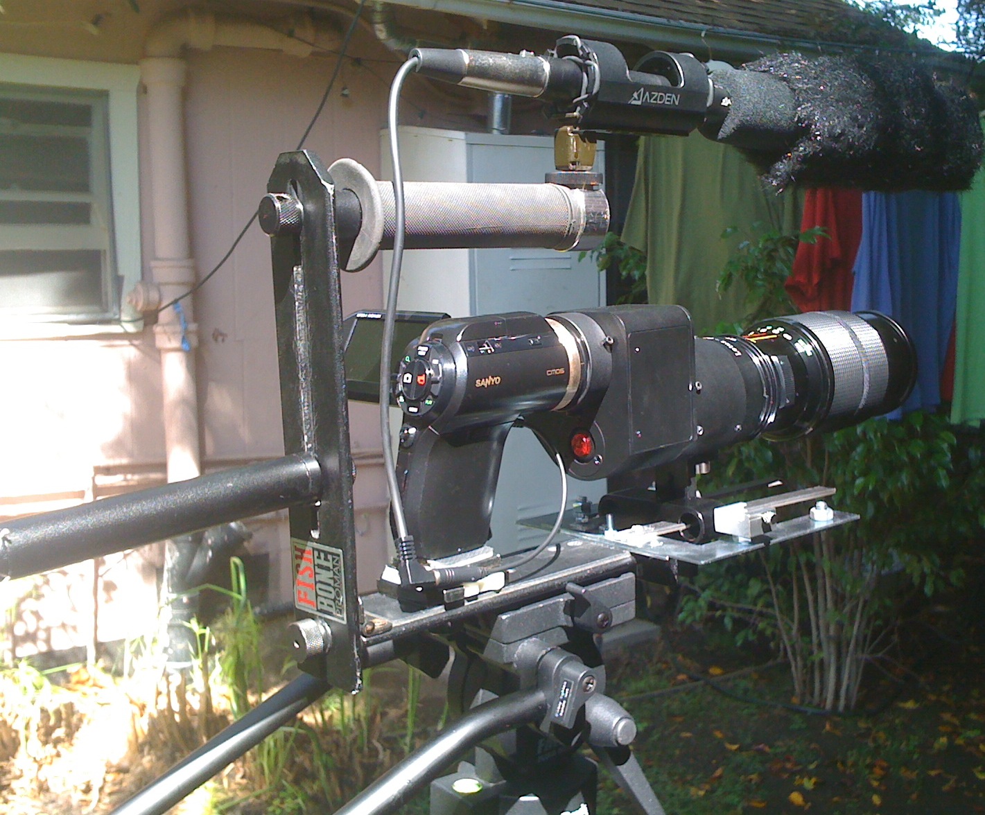

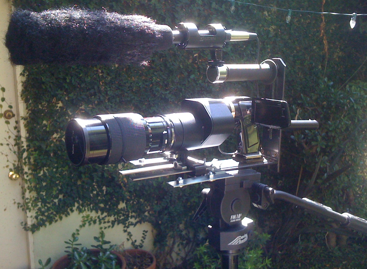

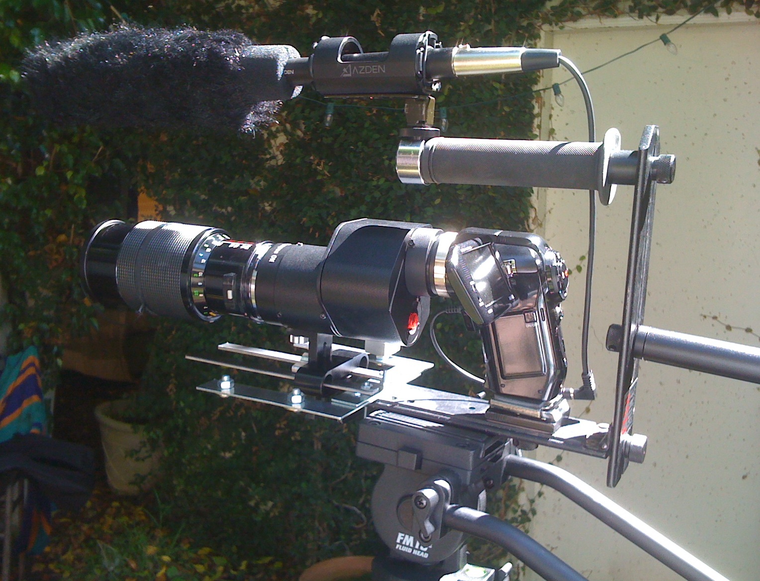

I successfully shot good footage using the Xacti HD2000 with the 40.5mm to 43mm step-up ring on a Letus mini ( http://www.letusdirect.com/cart/letus35-mini.html ). I have an OM Olympus adapter and a bunch of lenses, but I mostly used the 50mm, 134mm and 24mm as are faster lenses. Very happy with the camera, but today I have a problem with the mic input. I thought the one of the cable is damaged but they are not ( http://www.bhphotovideo.com/c/product/133646-REG/Comprehensive_XLRJ_MPS_18INST_EXF_Ste...specifications ). I'm using a Azden 2X ( http://www.bhphotovideo.com/c/product/204722-REG/Azden_SGM_2X_SGM_2X_Omni_Supercardioi....html#features ) boom mic self powered.
Battery good, cables good, so I guess the connection jack in the camera broke. Anybody had problems with the audio input?

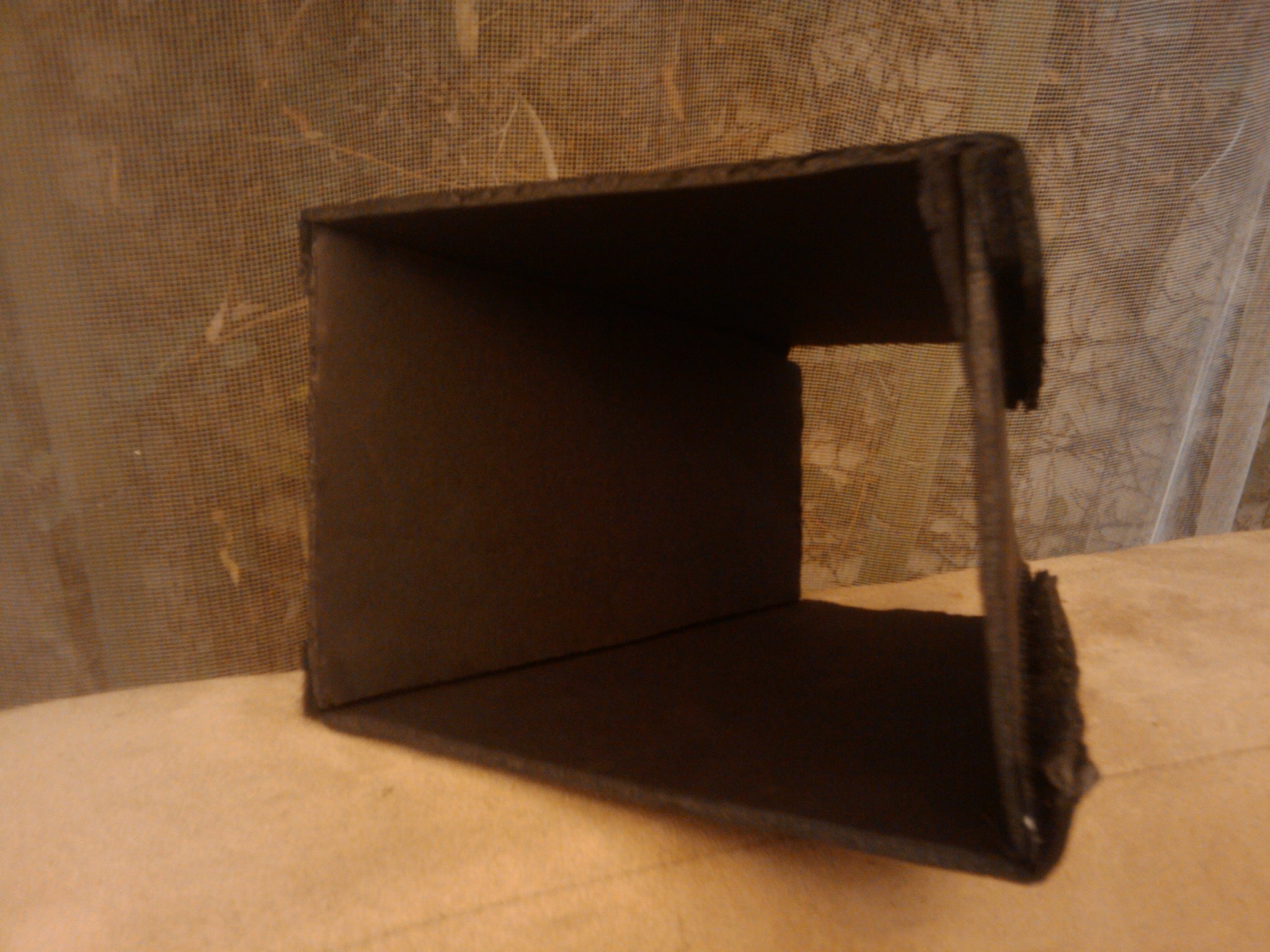

also made a "mattebox" (lens shade to fight the glare) of black cardboard and velcro:
2009-12-17%2012.25.02.jpg -
