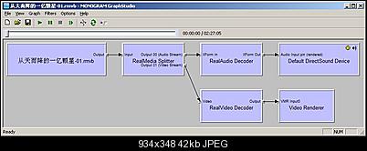

    My graph diagram looks like following till step 5
    http://img691.imageshack.us/img691/1882/graphedit.jpg
    Am i on the right way?
    Thanks for help.

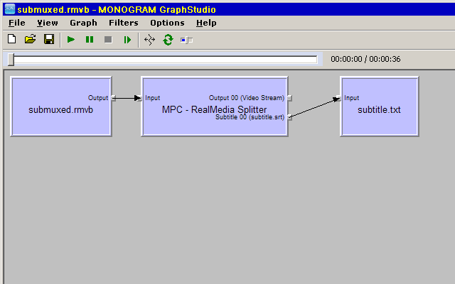

    The picture below "shows it all":

    P.S.: You will have to do some edit in Notepad, Wordpad, etc.,
    because the resulting file contains some "garbage" before the actual
    "subtitling content".
    P.P.S.: Differently from what I said some posts above, the RealMedia container does NOT support embedded subtitles. What happens is, the subtitle streams are attached after the "official" RealMedia "End-Of-File mark", and the DS filter "Real Media Splitter" was designed to detect such "attachments" as embedded subtitles...

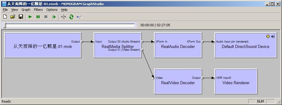

  11. Hmm... my graph does not have Subtitle 00 (subtitle.srt).
    I guess my rmvb's subtitle is actually graphics attacted to the movie?
    Anyway, thank you again Heggunte
