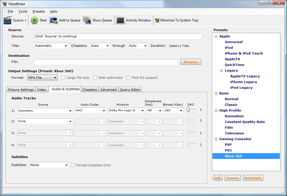

Alright, it looks like .mp4 might work but I'm not sure. I looked around on the Handbrake wiki and found that there is a Xbox 360 profile. I took a screen shot of it here (mainly in case anyone else comes across this thread.)

Alright, I've run some tests and I have some results. I ran several tests on a roughly 9.5 minute section of video that I ripped from a DVD (using AnyDVD) - this is just the first few chapters of a movie (once I saw that I could set which chapters to encode, I figured this would be a much faster way to test than doing a whole movie each time.) A few general notes - whenever I selected subtitles, it burned them in ("hard" subtitles.) I don't know of a way to get optional ("soft") subtitles. Also, I left each test at the standard settings except where indicated (so each one is at 2000 bitrate, etc.) Here's the info from Handbrake for each one:
I then put all of these on a USB drive and put that into my XBox 360. I first made sure that I had all the most recent updates. When I went to the movies option in the My Xbox menu, I navigated to the folder the test files were in and only 7 showed up - all the .mkv files weren't even recognized as movies. So much for the .mkv containerCode:Default Eng Subs -i "C:\DVDRip\Movie" -t 1 -c 1-3 -o "C:\Users\Name\Desktop\Xbox 360 Tests\DefaultEngSubs.mp4" -f mp4 -p -e x264 -b 2000 -a 1 -E faac -B 160 -R 48 -6 dpl2 -D 1 -s 1 -x level=40:ref=2:mixed-refs=1:bframes=3:weightb=1:subq=9:direct=auto:b- pyramid=1:me=umh:analyse=all:no-fast-pskip=1:deblock=-2,-1 -v DefaultAC3EngSubs.mp4 -i "C:\DVDRip\Movie" -t 1 -c 1-3 -o "C:\Users\Name\Desktop\Xbox 360 Tests\DefaultAC3EngSubs.mp4" -f mp4 -p -e x264 -b 2000 -a 1 -E ac3 -B 160 -R 48 -6 dpl2 -D 1 -s 1 -x level=40:ref=2:mixed-refs=1:bframes=3:weightb=1:subq=9:direct=auto:b- pyramid=1:me=umh:analyse=all:no-fast-pskip=1:deblock=-2,-1 -v MKVAC3EngSubs.mkv -i "C:\DVDRip\Movie" -t 1 -c 1-3 -o "C:\Users\Name\Desktop\Xbox 360 Tests\MKVAC3EngSubs.mkv" -f mkv -p -e x264 -b 2000 -a 1 -E ac3 -B 160 -R 48 -6 dpl2 -D 1 -s 1 -x level=40:ref=2:mixed-refs=1:bframes=3:weightb=1:subq=9:direct=auto:b- pyramid=1:me=umh:analyse=all:no-fast-pskip=1:deblock=-2,-1 -v MKVAC3EngSubs2Pass.mkv -i "C:\DVDRip\Movie" -t 1 -c 1-3 -o "C:\Users\Name\Desktop\Xbox 360 Tests\MKVAC3EngSubs2Pass.mkv" -f mkv -p -e x264 -b 2000 -2 -a 1 -E ac3 -B 160 -R 48 -6 dpl2 -D 1 -s 1 -x level=40:ref=2:mixed-refs=1:bframes=3:weightb=1:subq=9:direct=auto:b -pyramid=1:me=umh:analyse=all:no-fast-pskip=1:deblock=-2,-1 -v XviDAC3EngSubs2Pass.mp4 -i "C:\DVDRip\Movie" -t 1 -c 1-3 -o "C:\Users\Name\Desktop\Xbox 360 Tests\XviDAC3EngSubs2Pass.mp4" -f mp4 -p -e xvid -b 2000 -2 -a 1 -E ac3 -B 160 -R 48 -6 dpl2 -D 1 -s 1 -v XviDAC3EngSubs.mp4 -i "C:\DVDRip\Movie" -t 1 -c 1-3 -o "C:\Users\Name\Desktop\Xbox 360 Tests\XviDAC3EngSubs.mp4" -f mp4 -p -e xvid -b 2000 -a 1 -E ac3 -B 160 -R 48 -6 dpl2 -D 1 -s 1 -v XviDAVIAC3EngSubs.avi -i "C:\DVDRip\Movie" -t 1 -c 1-3 -o "C:\Users\Name\Desktop\Xbox 360 Tests\XviDAVIAC3EngSubs.avi" -f avi -p -e xvid -b 2000 -a 1 -E ac3 -B 160 -R 48 -6 dpl2 -D 1 -s 1 -v XviDAVImp3256kbps.avi -i "C:\DVDRip\Movie" -t 1 -c 1-3 -o "C:\Users\Name\Desktop\Xbox 360 Tests\XviDAVImp3256kbps.avi" -f avi -p -e xvid -b 2000 -a 1 -E lame -B 256 -R 0 -6 dpl2 -D 1 -v XviDAAC160.mp4 -i "C:\DVDRip\Movie" -t 1 -c 1-3 -o "C:\Users\Name\Desktop\Xbox 360 Tests\XviDAAC160.mp4" -f mp4 -p -e xvid -b 2000 -a 1 -E faac -B 160 -R 0 -6 dpl2 -D 1 -v
Of the rest, only 3 of them actually played (the others gave me an error about codecs not being supported.) The three that actually worked were:
DefaultEngSubs.mp4
The good news is it looks like you can make .avi files that have AC3 (6 channel 5.1 surround) and "hard" subtitles - all using Handbrake. The not-so-good news is that these files will be pretty large.
For what it's worth, here's the MediaInfo data on that XviD .avi with AC3 audio:
Code:Format : AVI Format/Info : Audio Video Interleave File size : 168 MiB Duration : 9mn 41s Overall bit rate : 2 425 Kbps Video ID : 0 Format : MPEG-4 Visual Format profile : Simple@L3 Format settings, BVOP : No Format settings, QPel : No Format settings, GMC : No warppoints Format settings, Matrix : Default (H.263) Codec ID : XVID Codec ID/Hint : XviD Duration : 9mn 41s Bit rate : 1 966 Kbps Width : 708 pixels Height : 480 pixels Display aspect ratio : 16:9 Frame rate : 23.976 fps Resolution : 24 bits Colorimetry : 4:2:0 Scan type : Progressive Bits/(Pixel*Frame) : 0.241 Stream size : 136 MiB (81%) Writing library : XviD 1.1.2 (UTC 2006-11-01) Audio ID : 1 Format : AC-3 Format/Info : Audio Coding 3 Codec ID : 2000 Duration : 9mn 41s Bit rate mode : Constant Bit rate : 448 Kbps Channel(s) : 6 channels Channel positions : Front: L C R, Surround: L R, LFE Sampling rate : 48.0 KHz Stream size : 31.1 MiB (18%) Alignment : Aligned on interleaves Interleave, duration : 32 ms (0.77 video frame)
