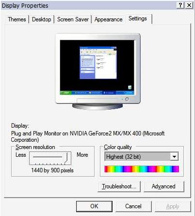

Press the Advanced button on that dialog. That will bring up tne Plug and Play Monitor... dialog. Go to the Monitor tab and select the refresh rate:
