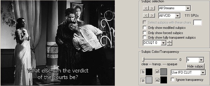

  2. You can make subtitles for it, which means you won't have to reencode the movie. You'll only have to get the times that the intertitles are on screen. Then I think I would make the usually transparent background opaque:
    This is done in DVDSubEdit afterwards. I don't have a silent film on the hard drive on which to test, but you get the idea. You'd set up the subs originally to be in the middle, rather than at the bottom. I don't use Subtitle Workshop to create subs, but I believe in it you can even define the size of the background so it takes up as much or as little of the screen as you like, in case you want to keep a part of the original intertitle, like the nice design work of your bottom example. The background usually (but not always) takes up the entire screen. You can also change its color, if you like. This one was originally a light grey. The opaque background would be on screen only when the subs are.

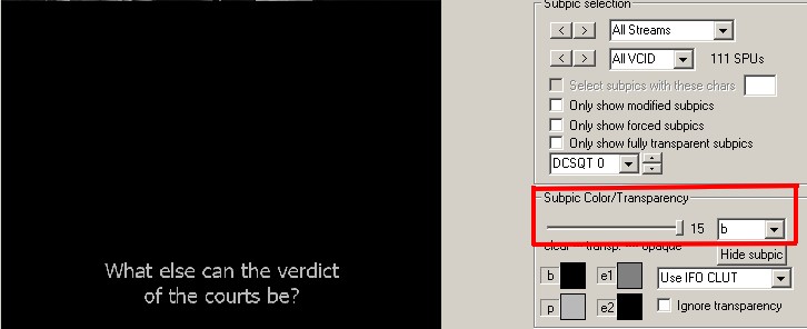

    So you're suggesting that I make the screen fade-black at the moments that original intertitles shows up and replace my handmade subtitle with it. it's a great idea and it works, but I'll lose the original font,pictures,shapes,visual of the intertitles, you know what I mean? I mean is there any way to replace my words with the original intertitle without ruining the visual,shape,pictures of the original one? cause I've seen many silent films on TV which translated without corrupting the original pictures,shapes,frames
    and by the way I can't fade-black my dvd with DVDSubEdit, don't know what's the problem :

    well I faded-black the picture, it was " e2 ", near the subpic color/transparency, so it I only could find a way to don't ruin the original frames ..

  7. Yeah, it's usually b (for background), but not always. You can also raise the dialog and the background color using the subpic vertical position slider. I guess your background is only at the bottom, where the one with which I was testing covered the entire screen. You can easily move them both up to the middle. And as I said before, I think SubtitleCreator allows you to choose the size and position of the background color. I seem to remember reading a post by AlanHK to that effect. Maybe he'll see this thread and comment.
