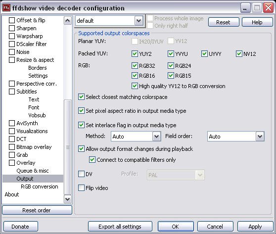

Ffdshow is a DirectShow decoding filter for decompressing most of video files (AVI, MPEGs, etc). If you have installed XviD codec for playing back XviD files, DivX for DivX files... you can try ffdshow filter by ticking the option "disabled" for each codec to "libavcodec" for example. You can evaluate the quality of that filter. And ffdshow combines some handy image postprocessing options. Of course, you can revert the changes by going "disabled" back !
In my case, I use this filter since a long time because of its large options and decoding codecs. Usually for MPEG-2, I chose "libmpeg2" in conjonction with the "Output" section in "Overlay" and tick "Set interlace flag in output media type" like showed down :
Thanks titigrom. I've now changed my setting to match yours, apart from mine already having one extra box checked. Is that significant? (I have no idea what 'Packed YUV' or 'NV12' means!)
Is it possible to explain in non-technical terms what the effect of your change is please? Where will I notice any difference?
Re all those types that I now have set by default as Disabled, would my safest approach (given my basic lack of understanding) simply be to 'wait and see'? IOW, wait until something doesn't work properly and then try changing it in ffdshow?
I suspect that the reason these were previously set as I showed in my earlier screenshot was that at some stage I must have used the option 'Set all stable formats to libavcodec', while in experiment mode, and forgotten all about it. Do you use that option and what are its advantages/disadvantages?
