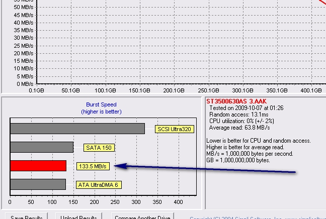

Download and run the quick test on each drive. Post the drive throughput numbers (the number in the red bar graph)
http://www.simplisoftware.com/Public/index.php?request=HdTach

Well, FYI I did all the tests and more. Also reinstalled the PCI in another slot. Removed the SATA drive and plugged it to the external SATA to USB and the 1Tera external drive to the PCI card. I backed up the whole 98GB contents of the drive in the external set up to the 1Tera drive in 1H, 9Min. Then I try to send 5GB from the 1T drive to the desktop, it frozed.
I have concluded that the PCI card can transfer data , normally, only one way. You cannot even play videos coming through that card.
