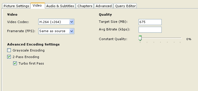

    There are small lines in about 30%-50% of my .ISO to .AVI conversions. They show up when there is fast motion in the video. Why is this, and why only in roughly half of the conversions?
    My settings are:
    Does anyone know how to resolve this?
