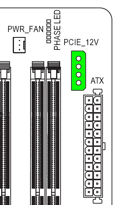

That's exactly what it is. On my MB diagram it shows an ATX_12V_2X connector with 8 pins but my board has a cover over half of the connector. It's a Gigabyte GA-EP35-DS3P. Can I pull the cover off the board and connect all 8 pins? I assumed half of it was covered for a reason.

What is up with Gigabyte putting that half-covered EPS12V connector on their desktop boards? I've heard of several like that. Apparently the EPS12V connector does work with the cover removed (so using all 8 pins) but I'm not guaranteeing anything because I've not seen it or tried it myself. I've also seen people using half the EPS12V connector pins but that's too risky since it won't latch into place that way and bumping a power connector out while the machine is running could be catastrophic. There should be a 4-pin power connector on there too somewhere, isn't there? My system uses the ATX, EPS12V, a 4-pin 12V, and a regular Molex 4-pin. Any EPS12V PSU should have both the 8-pin and 4-pin 12V connectors.

Nope!There should be a 4-pin power connector on there too somewhere, isn't there?
One 24/20 pin connector, one 8/4 pin EPS/ATX12V connector, four 8 pin PCI-E connectors, eight SATA connectors, eight periphial connectors and two floppy connectors.
EDIT: I do have a molex power connector on the board but I'm afraid to plug a cable into it.
I have no idea what it's for (looks like it's 12V out for PCI-E).
That's probably a 12v in for SLI or X-fireOriginally Posted by DarrellS

Is that what that is for? I've got one on my board but it doesn't support SLi/CF but does have two full x16 2.0 slots.Originally Posted by ocgwFB-DIMM are the real cause of global warming
I assumed it was to put an adapter to hook to your SLI/Crossfired video cards.
