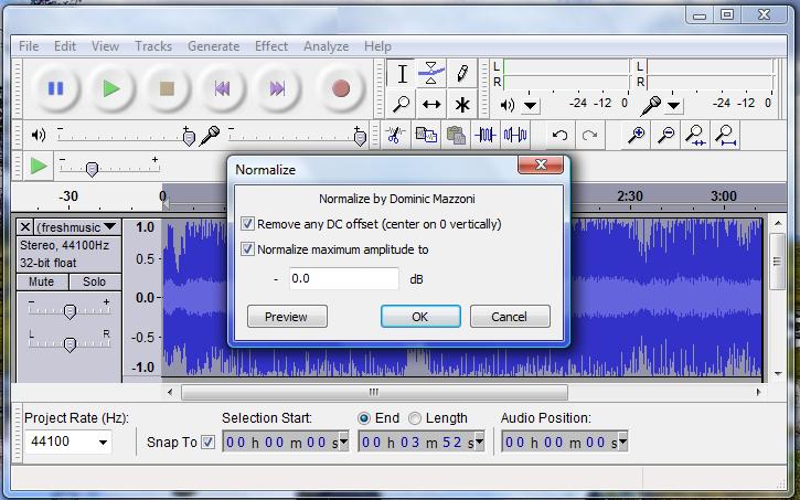

    USA
    From Audacity, I just see it setting the maximum amplitude to 0 db and centering the offset to 0.

    Normalising is usually a fairly crude process of making the highest peak in the waveform reach a set level from one file to another.
    Unfortunately the perceived loudness is way more complicated than that, depending upon frequency and 'density' of the waveform... dynamics, etc.
    Normalizing is adjusting the audio's amplitude against a specified decibel level (or a % that corresponds to a db level). It affects volume, but it's not necessarily "volume".
    Adjusting against the peak is best idea, from what I know, although "average loudness" can have uses if you have a few oddball peaks that can simply be clipped (noise pops or explosions, for example). Good software has anti-distortion filters to prevent the clipping from creating unwanted audio artifacts.

  5. @hech54 - you are indeed correct.
    Normalizing is a general data analysis term intended to compare multiple data sets (audio files). Each separate data set is rescaled such that the maximum value is (typically) unity. Doing this on multiple audio files would be akin to automatic gain control.
