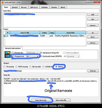

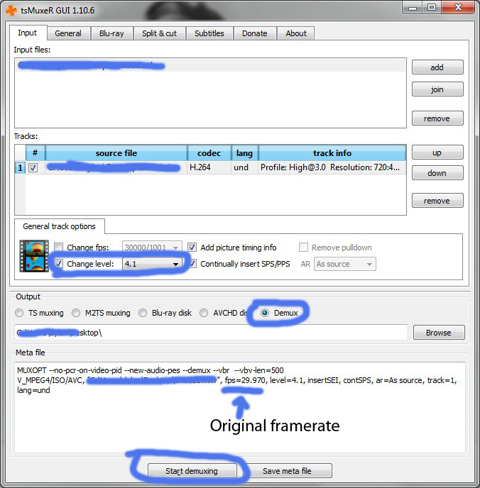

  21. Hi bigmike, since aI have the wd HD and an LG bluray too I think your problem might be the AVC level is above high@4.1 which isn't allowed, I find it happen to me be but it's no problem since all you have to do is trick it by using tsmuxer, the method is open the mkv in tsmuxer and tick Change level under general options and change it toop 4.1 or 4.0, select demux and then open the h.264 and aac file with mkvtoolnix when it ass for framerate type in the orginal framerate which can be found in the tsmuxer window under info or using mediainfo and remux it back to mkv.
  22. Originally Posted by dylz View Post
    I downloaded the programs you mentioned but when I tried to open the file in tsmuxer I don ont see the option u are mentioning. Is there a write up on how to do this possibly? Thank you.

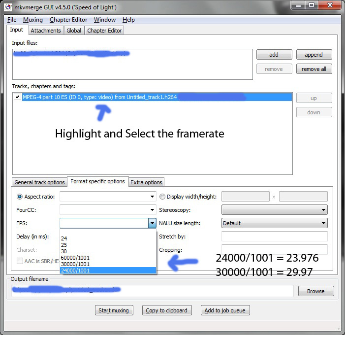

  23. Long time no reply lol, the tools are under videohelp tools section, tsmuxer got discontinued and taken down by the author and mkvtoolnix is everywhere just google it... i'll upload tsmuxer. To be clear open the mkv in tsmuxerGUI ( http://www.mediafire.com/?mh4d49996gu0v6m )
    click on the video and change level will become available change it to something like 4.0/4.1 and select to demux it then open the video and audio in mkvtoolnix ( mkvmergeGUI ) and ark the framrate what the original was ex:23.976 and mux back to a mkv.

    Thank you man! I tried this but with almost every movie i tried I got this error message:
    Matroska parse error: invlaid h264 NAL unit size. NAL unit truncated."
    ??? Have no idea what that is about?
  25. Never had that before , sounds to me like the original mkv is damaged so what i'd do is open the mkv in mkvtoolnix and remux just select start muxing at the bottom and try the new mkv in tsmuxer, actually when do you get the error? is it when you demuxwith tsmuxer, opening in tsmuxer or remuxing with mkvmerge? if you can't open it in tsmuxer you can download mkvextractGUI2 (google it) to use it extarct from the zip and place the exe file in mkvtoolnix directory under program files creat a shorcut on desktop or start menu, to run it start mkv extract, drag and drop the mkv and press extarct that easy the drop the video (h.264 file) in tsmuxer change the level, demux it and mux in mkvmerge.
