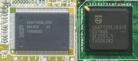

    If this does not solve the problem then try another video card. You need a card that can handle PAL60 system. It is easy to find and are cheap. All TV Tuner equipped with Philips SAA713x (x can be 0 to 5) chipset supports PAL60 and also work with DScaler at hardware level (without driver installated). Just few card with Philips ADC:
    Kworld V-Stream Studio TV Terminator, Kworld PVR-TV 7134SE, Asus MyCinema-P7131, Leadtek WinFast TV2100, Gigabyte GT-P5100.

    No this has conexant brain.
    Avermedia AVerTV Studio 709
    Avermedia AVerTV Hybrid+FM PCI
    Avermedia AVerTV Studio Model 507
    Avermedia AverTV-Super007
    Avermedia AverTV-Studio503
    KWorld PlusTV Hybrid PCI (DVB-T 210SE)
    Gigabyte GT-P6000
    Asus MyCinema-P7131H
    Anything with black beetles named Saa713x (x can be 0 to 5) is good. See image
