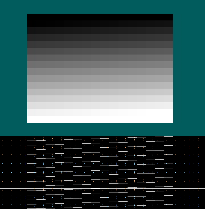

Encode a DV AVI source video with both settings. Compare the source and two output files with VirtualDub. Here's a sample DV AVI with all 256 luma levels:
blocks.avi
Note that VirtualDub performs the usual luma expansion when it displays the video. So the intensity extremes will look crushed. Video scope image:
If you use AviSynth's AviSource() to open a DV AVI and use the Info() command it will tell you what colorspace the DV decoder outputs.
The above image was created with VirtualDub and the following script:Code:AviSource("blocks.avi") Info()
Code:AviSource("blocks.avi") VideoScope() -

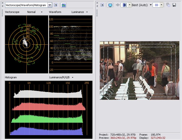

This is a typical waveform for consumer camcorder captures (Video8, Hi8, DV, HDV, AVCHD). Zero equals digital 16 and 100 equals digital 235. Note that white levels extend to 255 and there is even some clipping at 255.
If you clip whites to 235, you are doing this. It isn't shown in this frame but cloud detail in the sky is often lost to flat white.

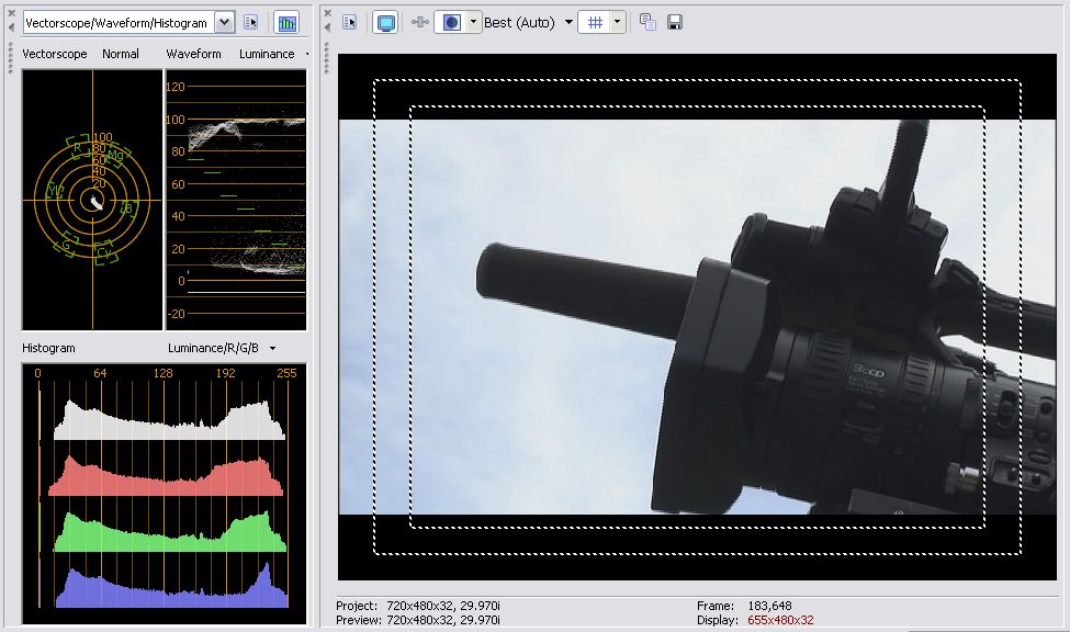

Pro camcorders manage white to nominal 235 so you don't notice this as much for broadcast captures. It is a consumer camcorder issue. This shot shows how Sony pro XDCAM cameras manage sky detail (bright whites). Note that there are still some excursions above 235.
