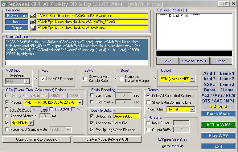

	BeSweet's PAL->NTSC(25.000 to 23.976) preset does a good job of slowing the audio and lowering the pitch. No pops. I don't much like its AC3 reencoding, so I'd make a WAV file of it first followed by reencoding to AC3 with something else. I use Soft Encode, but Aften (freeware) should do a decent job. I do this all the time with no problems.

	That should work. If not, did you have BeSweet set up like this:
 At the top you have to point to the BeSweet.exe, the input .ac3 file, and give a name and location for the output .wav file. Also, once you have a failed encode, you have to remove the small file created before running it again or it'll behave as you described.
