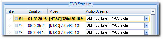

Ok. You are not selecting the audio correctly.
Lets take "How to lose a guy in 10 days":
When you load up the DVD you will get:
If you extract now you will get ALL the audio streams. This is because the audio selection is DEF i.e the default.
So, you need to select the single audio stream you wish to keep. If you double click on the Title it will begin to play. You can then use the audio selector to identify which audio you want (as the audio stream will change in the preview):
Lets say you want the 6 channel AC3 track.... You would then select it:
Extract now and this is the single track you will retain... All others will be discarded.
The point to remember is that if you have DEF: in the audio selection when you extract a Title - it will include all adudio tracts. In your case this is something you never want.SVCD2DVD v2.5, AVI/MPEG/HDTV/AviSynth/h264->DVD, PAL->NTSC conversion.
