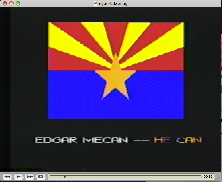

What am I doing wrong here..

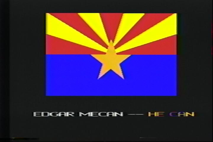

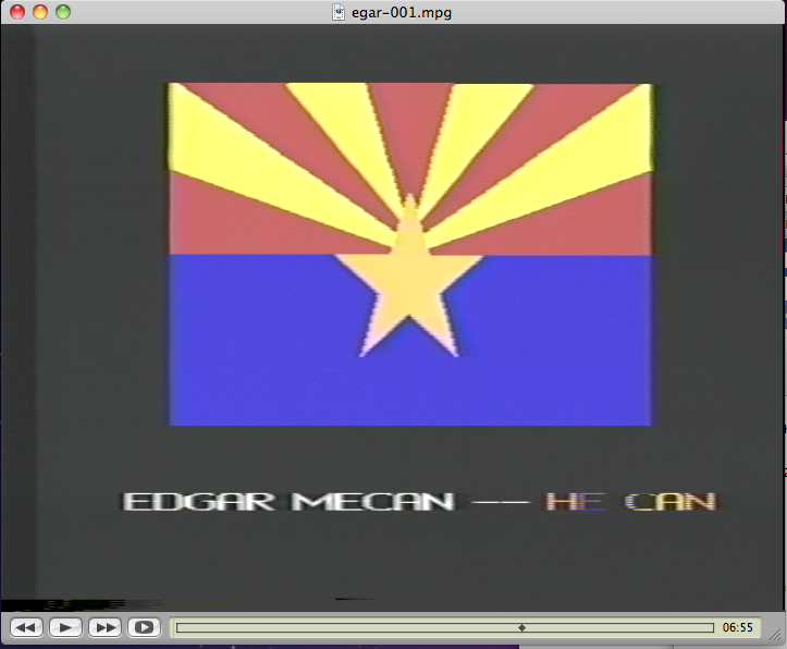

Here's an example.
With TBC:
Without TBC:
Notice how the word "Edgar" is blocky in the TBC capture.
What am I doing wrong?

Both clips are use the exact same capture settings. In fact, if I toggle the TBC switch during the capture the problem will come back and go way accordingly.Originally Posted by johns0
Your tape has errors that confuse the TBC.
It's not perfectly stable, but you could probably capture this one without the TBC engaged. It's close enough.

Interesting, the TBC has reversed the two fields positions.
Code:MPEG2Source("withtbc.d2v") ConvertToYUY2(interlaced=true) #so we can crop by odd numbers SeparateFields() v1=SelectEven().Crop(0,1,-0,-0).AddBorders(0,0,0,1) #shift this field up v2=SelectOdd() Interleave(v1,v2) Weave()
It added some jitter, too. I ran it through Restream, but it was still worse than the non-TBC version. Again, signal problems inherent to that tape caused it.
I've seen this before.
Sometimes the JVC does better than the Panasonic, on this exact error.Want my help? Ask here! (not via PM!)
This is not a field order problem that Restream can fix. The bottom field needs to be moved down by two scan lines, or the top field can be moved up by two scan lines. The earlier script moved the top field up two scan lines. This one moves the bottom field down two scan lines. The alignment is closer to the non-tbc cap.
HC m2v from this script:Code:MPEG2Source("withtbc.d2v") ConvertToYUY2(interlaced=true) #so we can crop by odd numbers SeparateFields() v1=SelectEven() v2=SelectOdd().Crop(0,0,-0,-1).AddBorders(0,1,0,0) #shift bottom field down Interleave(v1,v2) Weave() ConvertToYV12(interlaced=true)
hc.m2v -
lordsmurf: I forgot to share that the video was 'processed' through the genlock you could buy for the original Amiga 1000. It would wreck the video quality like how you see it.
jagabo: So I could run all my videos through with TBC on and if this happens again I can reprocess those specific goof-ups with yours script? It seems like it fixes the issue quite nicely.
