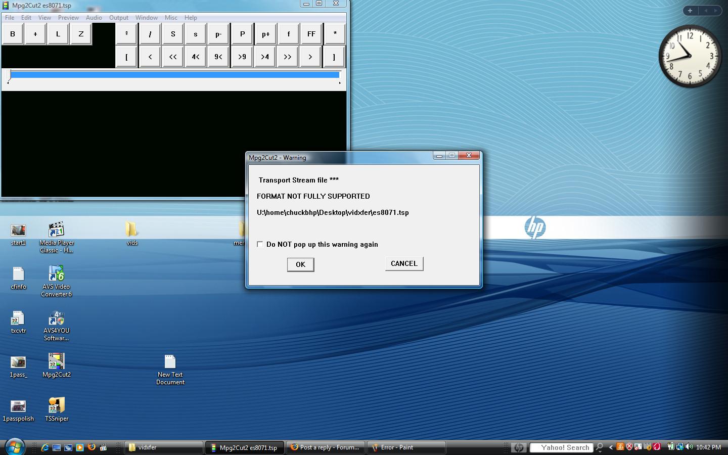

    Mpeg2Cut2 gives this warning:
    NO MPEG PACK/SEQ at start.
    This tell me anything?
    attachments limited to one per post?

    And another...
    Mar 2007
    And TSSniper gives this error:
  15. Well, you've tried just about everything I can think of. Do any of those apps open the TSP files that you can play?
