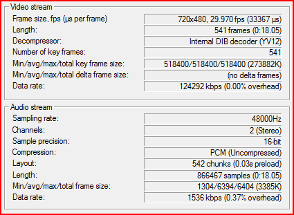

What does virtualdub say with the avs open? file=>file information -
Screen cap of File -> File Information

I tried playing it in windows media player as well as Premiere Pro CS3 - there are no audio levels showing up on the clip. Does it create a separate wav file?
I imported one of my m2ts clips into a friends Premiere Pro CS4 and there is definitely audio contained in the clips.
I'm going to test out exporting these m2ts files audio from CS4 to wav files - if I do that, will there be any sync files with the AVI files I'm creating from vdub?
Nope the audio should be in the AVI file
