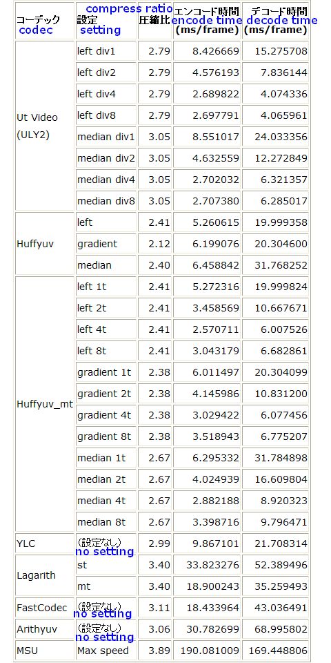

Now open that .avs file in virtualdub. Select video=>fast recompress, video=>compression (then select either lagarith, or huffyuv or ut video codec or some other lossless format, you may have to install them if you already haven't. I highly recommend UT video codec for lossless if you have a quadcore, its many times faster than lagarith and almost twice as fast as huffyuv-mt for decoding), then file=>save as avi. If you leave audio as direct stream copy, it will encode the audio as wav. If you wanted to disable this, just go audio=>no audio. Then you could import the native audio separately into premiere (you might demux it using tsmuxer for example) -
UT Video Codec
http://forum.doom9.org/showthread.php?t=143624
One "bug" is that it has to be set up in the configuration each time you use it to encode (it doesn't remember or save the settings). If you have a quad, set it to 4. If you have a i7 with HT, set decode to 8 threads etc... -

One question about UT video codec - I'm using an intel core i7 - you said it would run faster on this computer - however my other computer isn't quite as fast - for editing purposes, would it be better to stick with lagarith or were you just referring to the decoding process? -
For editing, you need fast decode speed. Lagarith, although commonly used, is fricking slow. Edits aren't very snappy even with a fast PC. (although you might be ok since it's only SD)Originally Posted by foochuck
Look at the decode times for UT vs . lagarith. It's 8x faster on a quad, but not as good compression. If you want best compression for YV12 formats, FFV1 (using ffdshow) is slightly better than lagarith
