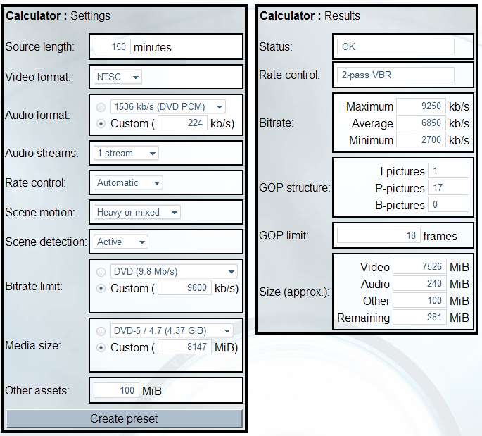

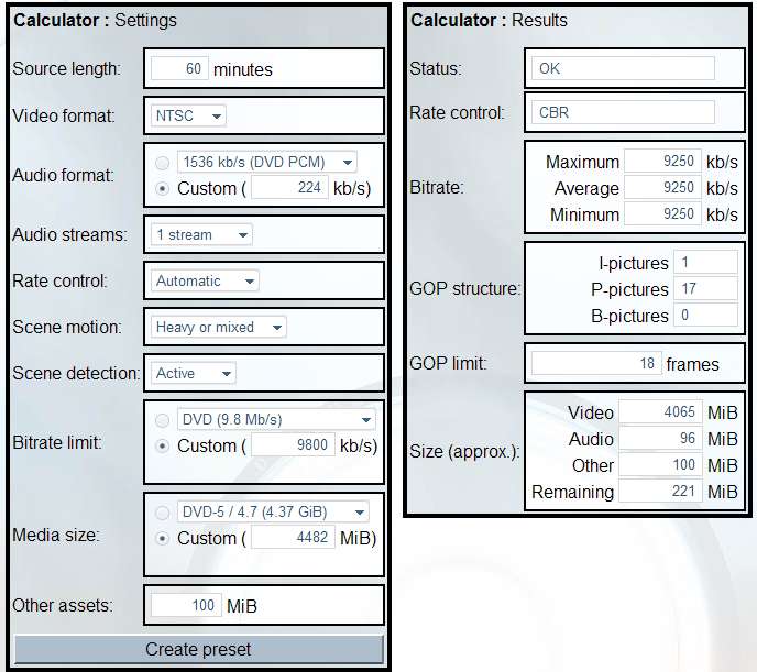

In a bitrate calculator (in signature) the settings are:
Project #2 (60 minute DVD):

Oh. I'm using this bitrate calculator to output the numbers. I assumed that CCE and TMPGEnc Xpress would both honor the calculated results the same way. :/
I'm confused how to reach the average and minimum bitrates using VBR CQ when the max, average and min are 9250 (second screenshot)?
Based on the calculator results, it says to use CBR. I'd like to try your recommendations so any help is appreciated.

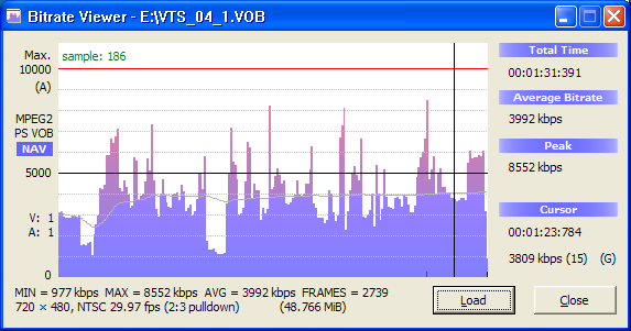

Note that with most sources there's not much improvement going over 8000 kbps or so. Use a Bitrate Viewer to examine the bitrate of your files. You'll find it interesting.
Updated (after posting): I just noticed your screenshot. I'll check the bitrate viewer.

Wow! The Bitrate Viewer is awesome! I can pinpoint the locations of the bitrates and where it dips and peaks.
Based on the encode it told me my minimum, average and maximum. One of the videos spiked to 10082.
Something tells me I need to lower the 9200 max setting.
Don't take Bitrate Viewer's bitrate peaks too seriously. The bitrate limit for DVD isn't for a single frame but rather the average over some short period. Bitrate Viewer lets you see the average over 1 frame, 1 second, or each GOP (usually about half a second). I don't know if either of the latter periods corresponds to the the DVD limit. On the other hand, I know a lot of people have recommended setting the max around 9000 or so.
