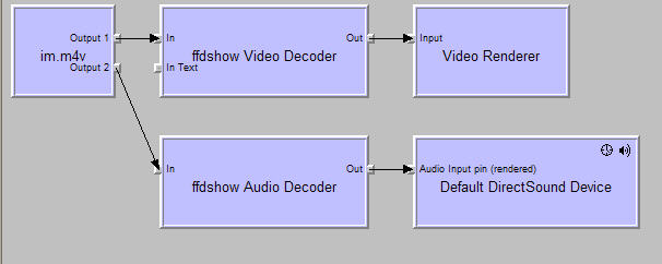

 If you render it in graphedit / graphstudio , do the pins connect?

 I'm clueless as to how to use Graphedit, but I could do "render media file" for an AVI and get a sequence of boxes showing AVIsplitte and ffdshow.
 For an M4V it gave the same "The specified module could not be found" message as Avisynth,
 and error code "0x8007007e".
	File=> render media file
 If it doesn't render, it means you are missing a filter somewhere in the directshow filter chain (this means directshowsource() won't work)

 Graphedit renders an mp4 showing the splitter MP4Splitter.ax and then ffdshow for audio and video.
