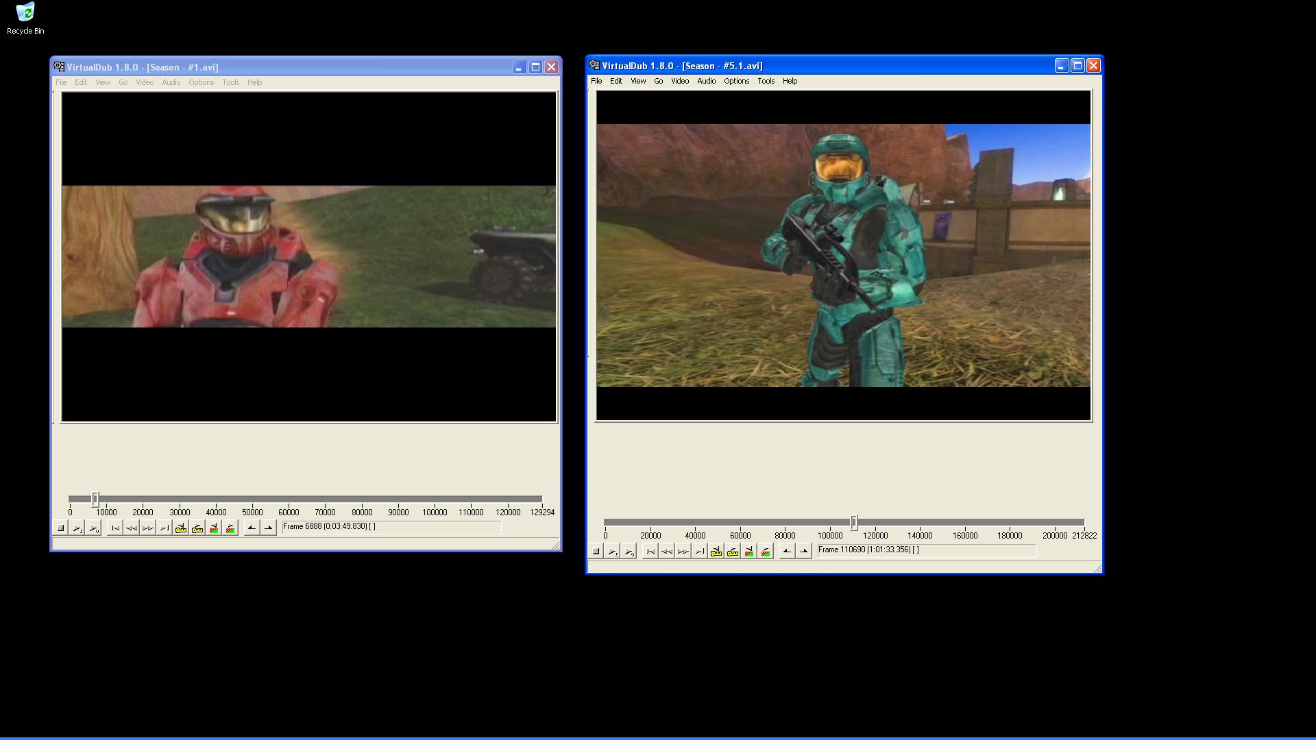

I am trying to fix up the original 5 seasons of RedvsBlue because the original video set up is horrible & I have a bit of a problem. I can get the type of set up I want with one Season but due to each season having different types of cropping areas I can not get each Season to match other. I want the 2nd image to match the first image & the other Seasons I would like them to match the first image but as I said the cropping for each season is a bit different & as I said my goal is to get the 2nd image to match the first image

First, use VirtualDub's Null Transform filter to enable you to activate the cropping tool. Crop to the desired framing, then use the Resize filter (Bicubic mode) to make sure the final output is the same aspect ratio as the video you like.
The cropped video will be more pixellated, as you will be doing a blow-up.
