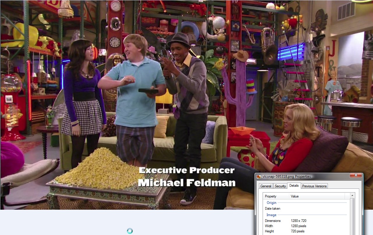

I finally caught this Disney show on Comcast-HD. The show just before "Hanna Montana" was 4:3 pillarbox 720p. "Sonny with a Chance" was 16x9 720p at 10-15Mb/s variable bitrate. I didn't realize DisneyHD was unblocked to IEEE-1394 here

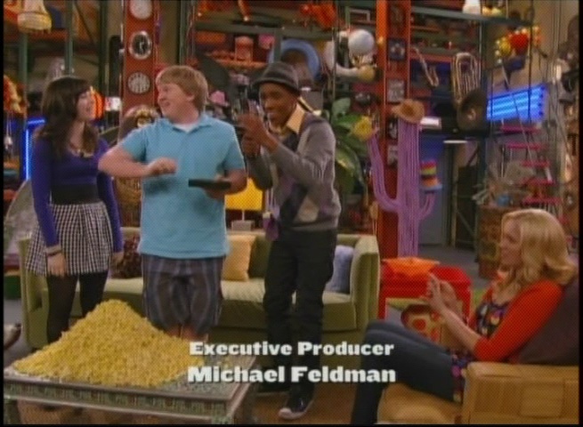

The SD Disney channel was showing side cropped 4X3 without pan or scan, just a center crop.
This is a screen cap of a VLC frame cap. Click on the pic for full size.

480i SD Disney Channel capture.
