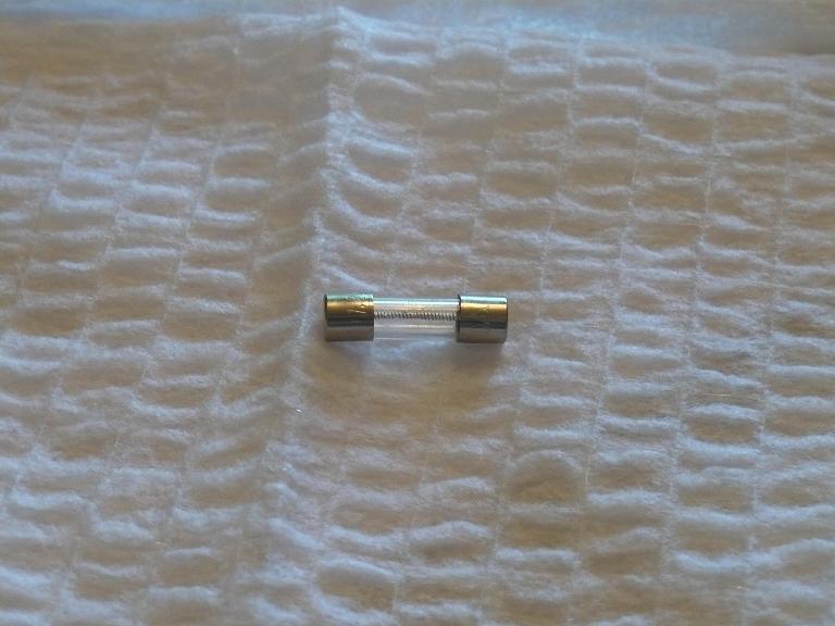

I do remember an old vcr I got used that didn't work. The resistor wasn't good so it was replaced and kept on working. I am wondering if this is the case here. Ok I don't know if it really is a resistor - I am not mechanically inclined as far as inner workings of parts. I know how to use stuff and assembling computer parts to a minor degree (snap in pci boards and stuff). But I don't solder and that kind of thing.
Here is a picture of what I took out and want to replace:
So could that be the culprit? Would replacing this be a good step to take?

That's a fuse....looks like a "Slo-Blo" (Slow Blow) one. I believe they still are available and yep...I'd try Radio Shack first.
Oh...and they should be pretty damn cheap. -

Thanks for the info. I'll definetely check it out and see if that might be the culprit.Donatello - The Shredder? Michelangelo - Maybe all that hardware is for making coleslaw? -
If you put some serious glasses on....you'll be able to read the volts, watts, etc etc on the metal ends of the fuse. Usually if a fuse blows there is something that caused it....something that a new fuse will not cure.....it may just pop again.

That fuse doesn't look blown to me, but I'm only looking at a picture. I suspect your problem lies elsewhere.

Well went to radioshack. THey didn't have the 1.25 250 fuse. They did have a 1.5 250 fuse for 4 pack for 3.00.
I tried it and the first one blew (blue spark). I tried another and it didn't blow but nothing else happened. Tried another still nothing.
I even went back to the original and nothing. Oh and by the way the newer ones had a smaller fillament then the old one.
I"m beginning to think I am getting in over my head. I even took the facia off thinking maybe the power button wasn't being depressed strongly enough. Nope didn't do anything.
