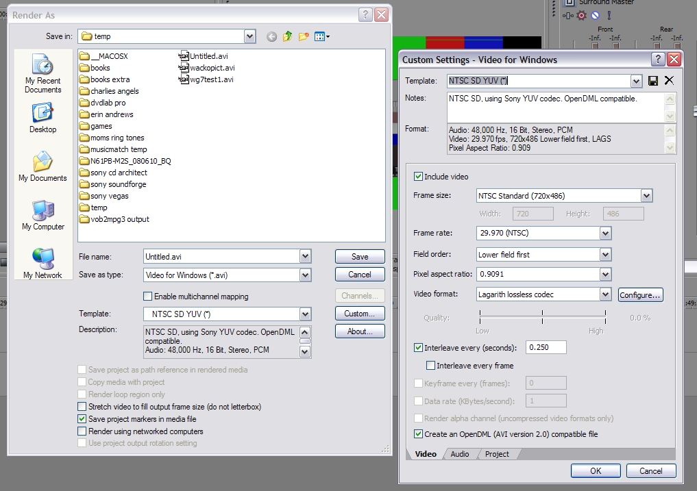

    i did a test render and found some settings that might help you.
    think of doing it in 2 parts - conforming the HDV to 4:3 and then the joining/editing. if you use these settings to render the HDV, you'll make a 720x486 uncompressed avi out of the HDV. make sure to do the pan and crop before exporting or vegas will just add black bars top and bottom to make it 4:3. you can change the codec, huffyuv or lagarith are lossless compressed or you could use pure uncompressed. the first 2 offer smaller file sizes.
    then you can make your second project settings 720x486 and things should line up properly.
    vegas - render settings screenshot
