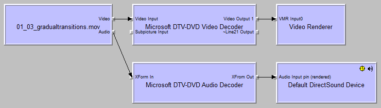

    I checked MP4/MOV in the 'Source Filters' and checked the H264/AVC (FFmpeg) in 'Transform Filters' and 'decoding thread number' was already set to 2.
    This is the graph I get in GraphStudio:
  10. OK you are on Win7, i missed that. I don't use Win7, but there are some tools and registry tweaks
    http://forum.doom9.org/showthread.php?t=146910
    Jun 2005
    The Netherlands
    With the tool from doom9.org, I set the default H.264/AVC decoder to FFDShow, but still no luck.
  12. There is a registry change on one of the pages in that thread, did you try it? Maybe you could as for more help there
    Jun 2005
    The Netherlands
    Yeah, I tried. But still no luck .
