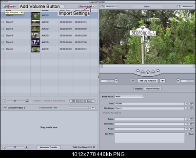

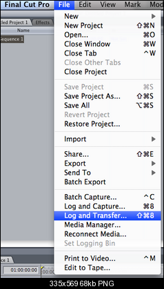

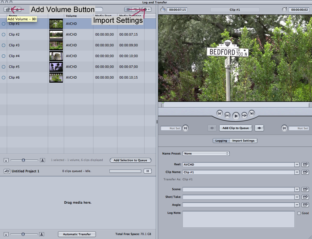

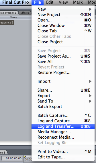

  8. The best method of doing this is to use the Log and Transfer window found in the File menu of Final Cut Pro.
ID:	3330Click image for larger version

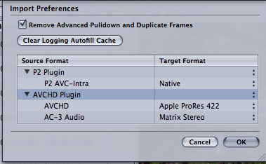

    In the settings menu ensure that Final Cut will convert AVCHD footage to ProRes.
    Name:  Imprt Preferences.png
    Apple have designed the ProRes codec to work quickly and easily with Final Cut.
    When your camera or card is connected you select it in the Log and Transfer window and it will display the files present. You can then select and transfer the shots you want to use. This method is pretty quick and also allows for renaming clips, adding meta data and placing In and Out points to select ranges for import.
    FCP even remembers the footage that you have transferred for reference later.
