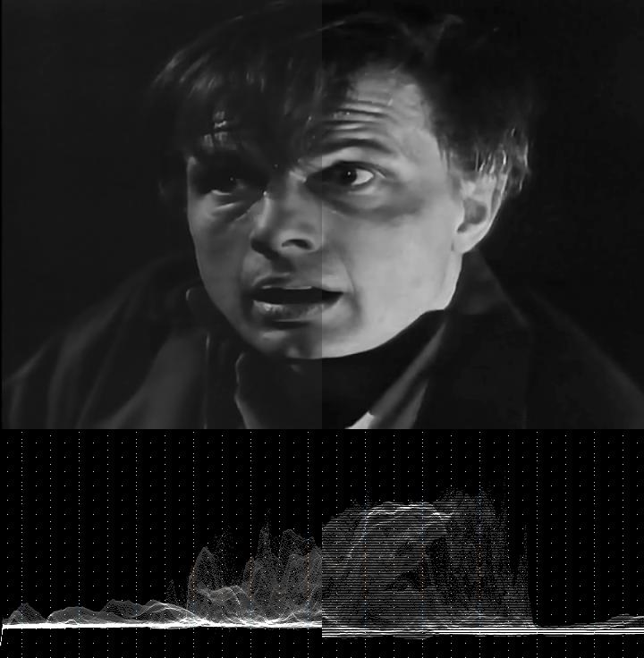

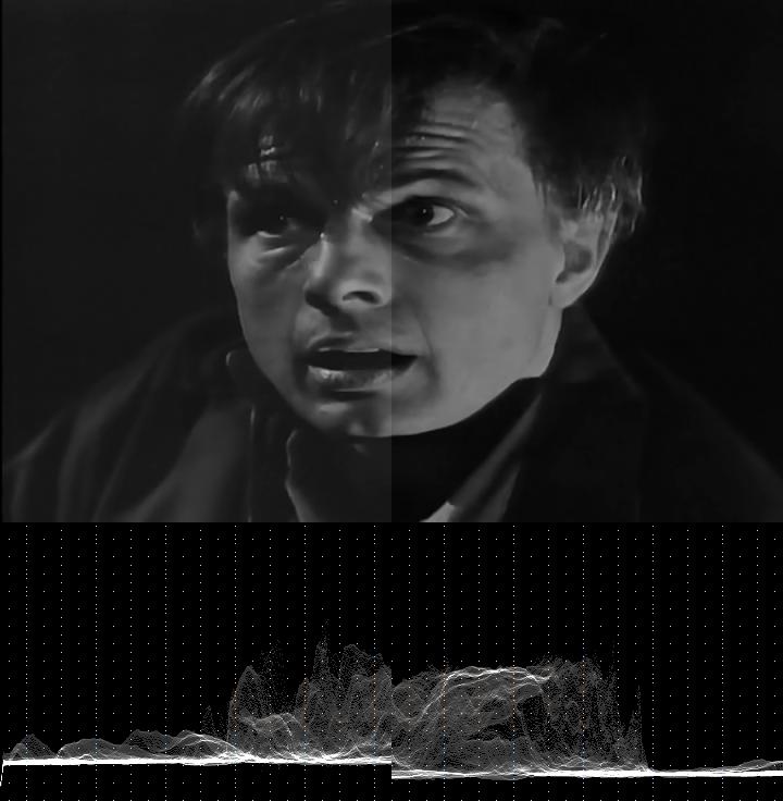

  10. I agree the black levels are off. Judging by the fade to black at the end (and the clip overall) the luma should be pulled down by 14. Given the dark scene it's hard to say if the gain should be bumped up. With just ColorYUV(off_y=-14), left is the original, right is the adjusted:

    Note that off_y had to be increased because gain_y increased the black level as well as the contrast. And the black level isn't all the way down to IRE 0 (Y=16) because that shot's black level is a little lighter than the fade to black at the end.
    That's an awful lot of gain so it's probably not right for the entire video. I would look through an entire episode and see what the brightest elements are and adjust gain for that.

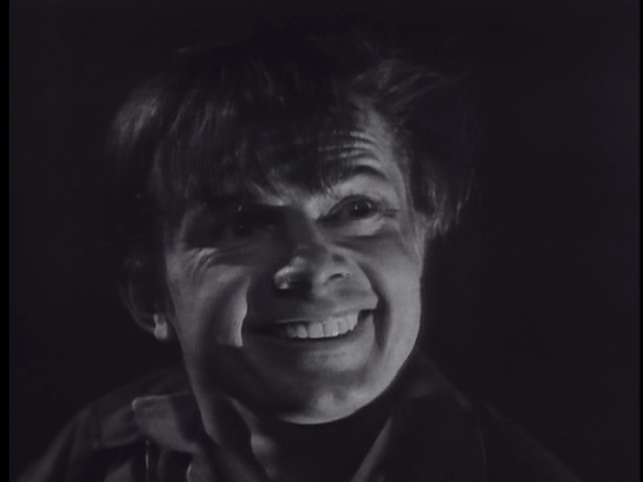

    Oh and the pic
