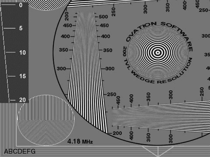

  2. If it involves the video it probably refers to the resizing filter used to shrink or enlarge frames. Take a small video, say 480x360, and enlarge it to 720x480. Look carefully at the resulting frame. Different resizing filters result in different sharpness and different artifacts.
    480x360 test pattern:
    720x480 Point (Nearest Neighbor) enlargement, ugly:
    720x480 Precise Bilinear enlargement, few artifacts but not very sharp:
    720x480 Precise Bicubic enlargement, few artifacts, sharper, but some oversharpening halos:

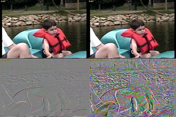

  17. Those video frames in those two clips were identical. I used an AviSynth script that subtracts one image from the other then amplifies the differences. But there were none. Here's what it looks like when there are differences (two different frames are being compared here, frame 39 in one video, frame 40 in the other, nearly no motion between the two frames, images half size for posting):
    And here's what comparing the two videos gave:
    The big expanses of gray at the bottom mean the frames are identical.

    Thanks for taking the time to review and analyze these. And thanks for providing the answer that I wanted to hear.
    Nov 2007
    One final question -- would the above analysis have reflected differences in all parameters, including brightness? I could swear that the one on the right looks a little brighter (e.g., the boy's hair color, the dark portions of the water, the grass on the bank behind the water). But one would think that "resampling" wouldn't affect that. Do you recall whether the A and B listed in the corners of your posted frames of the two different videos correspond to the "A" and "B" of the samples I posted?
  20. If every pixel had been N units lighter or darker you would be able to tell by the shade of gray in the differences images. The 128,128,128 (R,G,B) in the comparison indicates there was zero difference.
    Yes, A corresponded to Sample A, and B corresponded to Sample B. I just made the names shorter so it would be easier to type them into the Avisynth script.
