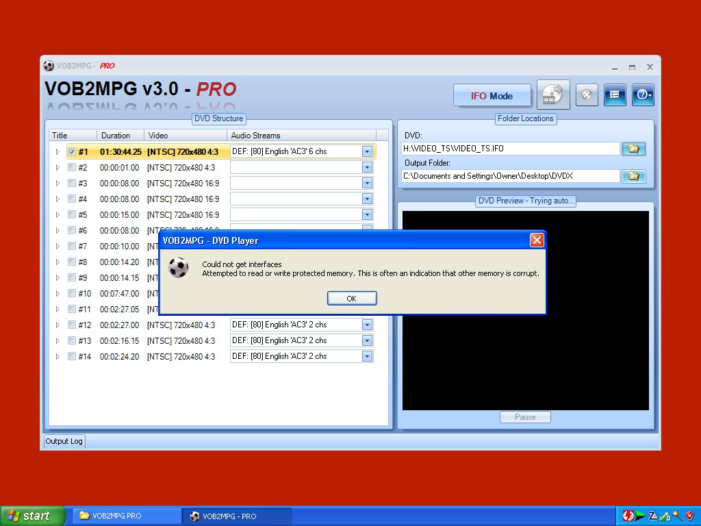

I am also getting an error saying "insufficient decoders" which is related to playing the preview I think.
Thank you. -
