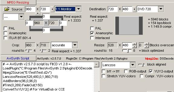

I have an MKV file which is 960 x 720 and I need to convert it to 638 x 480, adding side borders to fill in the 16:9 screen.
As I am using avisynth, what numbers should I put for resize and addborders? How do I get to those numbers?

You would get slightly better compression with:Code:
WhateverResize(638,480) AddBorders(108,0,108,0)
But I don't think that's really what you want to do. Are you making a DVD? In that case you'd want:Code:WhateverResize(640,480) AddBorders(112,0,102,0)
Then encode as 16:9.Code:WhateverResize(528,480) AddBorders(96,0,96,0)
Sorry, they didn't work. First was rejected by AvsP for YV12 width not being a multiple of 4. Second is rejected by HCenc for width not being a multiple of 16.
On the tests I did, the closer I got to what I think should be was suggested by FitCD. But didn't quite get there. They suggested this:
1) BicubicResize(640,480,0,0.6,0,0,960,720)
AddBorders(40,0,40,0)

It will display incorrectly when you burn it to a DVD. 560x480 is too wide. 528x480 is correct.
You should learn how to use FitCD properly. Both your 1) and 2) were derived incorrectly, Nor should you go around "splitting the difference" when you don't have a clue about what you're doing. Just for starters, your source isn't DVD 720 but 1:1 Monitor. Your "splitting the difference" script accidently comes close enough that you may not be able to tell it's wrong, but jagabo's third script does it correctly.Originally Posted by carlmart
Then the question becomes why would you want to encode a 4:3 source as 16:9 when you lose more resolution than necessary by wasting valuable space with pillar bars? -

By resizing for 4:3 encoding:Originally Posted by carlmart
LanczosResize(704,480)
AddBorders(8,0,8,0) -

So I now tried the first jagabo script, and it worked quite properly sized, with no morph distortions. -
