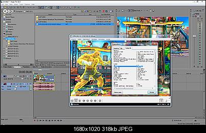

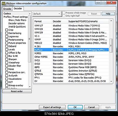

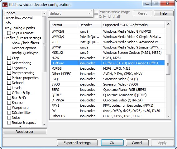

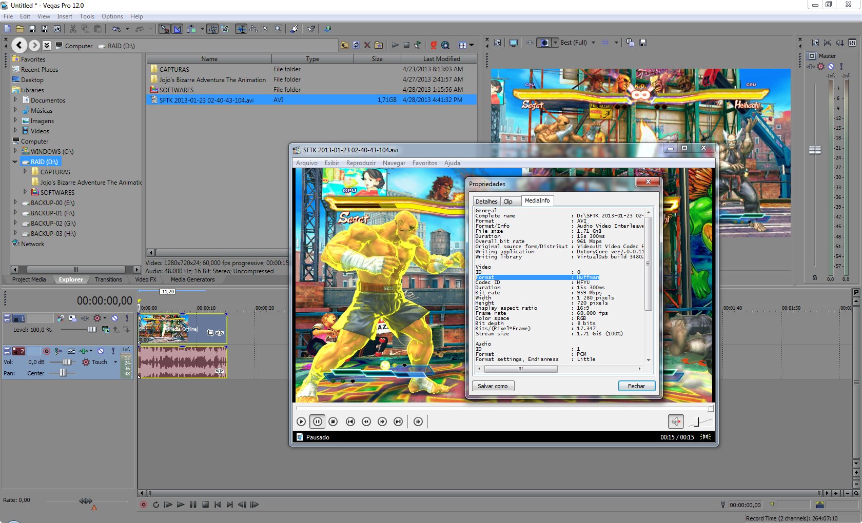

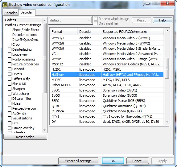

    Its VERY EASY my friend.
    Just install FFDSHOW 32 and 64bits, config by shots and open in VEGAS 64bits (My is Vegas Pro 12, only 64bits)

    Not work on your PC Jon.G
    Try any codec pack? I use K-lite Mega pack here. Open all files on VD, VEGAS, PD...
