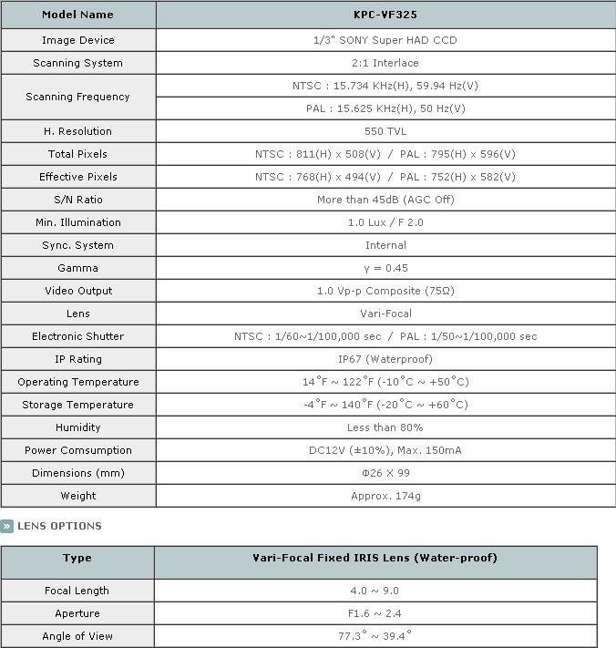

Regarding sensor and camera processing. Here's the specs for the helmet camera. Frankly, I'm not sure which it is 4:3 or 16:9.
Scan rates are normal NTSC. I'd assume 4:3 but an anamorphic lens could make it wide. This unlikely since it is not mentioned in the feature set. This camera lacks optical stabilization.
http://www.123securityproducts.com/kpcvf325nh.htmlRecommends: Kiva.org - Loans that change lives.
