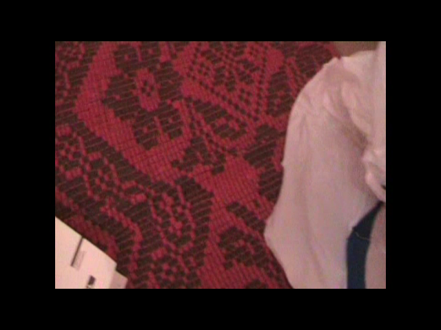

    Here it is: my brother took some videos with a video camera, and then send me those videos in order to make a presentation for him. The files are on .vob format, resolution 720x576, 16:9 aspect ratio, but for some reason the image is centered and bordered by black margins on top, bottom, left and right.
    In Bsplayer, full screen mode with Pan&Scan 0% looks like in SnapShot1 photo. I have to set Pan&Scan to around 33% in Bsplayer if I want to see only the video, without any borders.

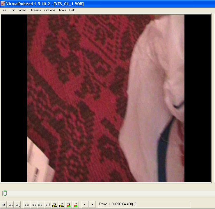

    Until now I've tried to crop the borders with VirtualDubMode and Avidemux, but when I open the files, both programs showed me a stretched image without any borders on top and on the bottom, like in SnapShot2. I alse tried to convert the .vob files to .avi, and I ended up with the same stretched image in the video.

    Here's the Snapshot2 photo with the stretched image:

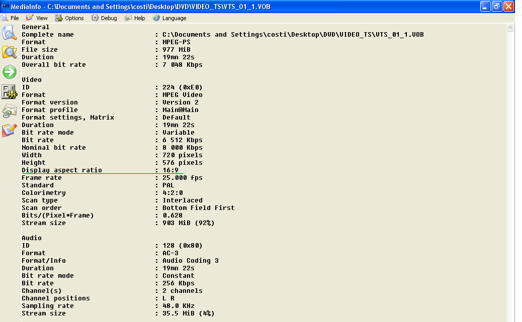

    use mediainfo on the vobs and see if it says 16/9 or 4:3. dvd spec mpeg-2 only comes as 720x576 for pal, to show widescreen there is a flag that tells the player to stretch the video to 16/9. otherwise it's shown as 4:3. a third possibility is that it's 16/9 encoded with black borders into a 4:3 box, but it's not used much.

    It looks to me like your brother should have made a 4:3 DVD, but for reasons of his own decided to make it 16:9 by adding black pillar bars. The image in Snapshot2 is the actual image as stored in the 720x576 VOB files. At playback time it gets resized so the image looks 'normal' again. The only black in that DVD is to the sides. That Snapshot1 from BS Player is a red herring.
    It's possible to remove the bars from the sides, but to keep the aspect ratio you'll also have to crop from the top and bottom. That's if you want to reencode it as 16:9. Or you could crop away the bars on the sides and reencode it as 4:3, which he should have done in the first place, I think.
    The MediaInfo says that the aspect ratio is 16:9 (see the photo attached).
