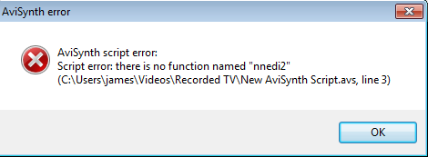

    i get this when i open the avs file
  11. nnedi2.dll has to be in the avisynth plugins directory
    or load it manually with LoadPlugin()
