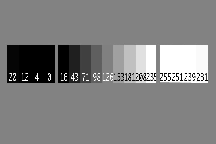

Here's a short MPG file with some levels test blocks:
levels.mpg
When you watch it on a computer or TV it should look like this:
Note that the blocks labeled 0, 4, and 12 should all be perfectly black. You should not be able to see any difference between them. The block labeled 20 should be just barely lighter than those three (but many monitors do not differentiate very dark blacks well). At the high end, the blocks labeled 255, 251, and 239 should all be full white. You should not be able to see any difference between them. The block labeled 231 should be a tiny bit darker. You should easily be able t see the difference between all the blocks in the 16 to 235 range.
Some editors may display the MPG file like this:
You should be able to differentiate all the different blocks in that image (0 and 4 might be very hard to tell apart). This is how the luma channel inside the MPG file is stored, but now how it should be displayed. A properly encoded MPG movie should not have blacks as black as the 0, 4 and 12 blocks (nothing below 16). And should not have whites as bright as the 239, 251 and 255 blocks (nothing above 235).
After conversion to another container and codec you should see the same thing. -
