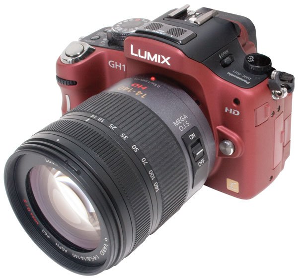

the gh1 looks like an overpriced toy and there isn't any good glass for it.

No good glass? Is this so? I thought the whole idea was getting 35mm DOF. What budget solutions do you like, aedipuss?

last I looked, a major feature of the SLR was interchangable lenses
most HD DSLR's record audio in stereo
ROTFLMAO
So the point here is the lenses for Panasonic are not the best? I'm sure they will do. As far as audio goes, if I use my Shure A96F transformer and Sennheiser, I'm in business. No? Use one channel of the audio...no?
hehe - it's your cash. if if set shots with no change of distance is all you are going to be recording the gh1 should work fine. <strike>what it doesn't have is the ability to change focus on the fly like a vid cam does. you must depress the shutter button half way to refocus.</strike>
edit - sorry bad info - unlike the canon and nikon dslr's the gh1 can refocus without user intervention.--
"a lot of people are better dead" - prisoner KSC2-303 -
From a photographic viewpoint the lenses of the Panasonic are not bad. They use a 4/3rds imaging system and share the lens mount with Leica and Olympus (Leica and Panasonic co-produce a lot of photo product together now).
If the Pnasonic lenses are not up to snuff the Olympus ones will be and the Leica ones certainly will be.
Another advantage to this lens mounting system is that it is ready made for adapters to other systems mounts. Ie, you can use Nikon, Canon, Minolta, etc. lenses on it, but you give up features (like autofocus and auto exposure). Primarily the adapters are for manual focus 35mm systems but I have seen some for the Maxxum and EOS mounts on Ebay. The 4/3rds system is a 2x magnification system in terms of 35mm point of view. So for a 28mm wideangle lens the camera will see the equivlent point of view of a 56mm lens for a 35mm film system. Grat on the tele end but crummy for the wide angles.
Whether or not any of this serves your needs I don't know, but it is a system with a lot of versatility in a general purpose way.

There's a lot of misinformation about this camera on this thread.
First off, this is a quote from a review by digitalcamerainfo.com:
"We were pleasantly surprised with the GH1's autofocus system as well. You don't have to push the shutter button halfway to engage it, and the camera doesn't make any loud noises when it attempts to focus—both of which were problems on the Canon T1i and Nikon D5000. The GH1's autofocus wasn't quite as good as a regular camcorder's, but it was pretty darn close."
The review goes on to conclude:
"Judging it solely on its video capability, the Panasonic GH1 ($1499.95 MSRP) is a strong camera. It is the first video-capable DSLR that truly offers the gamut of manual controls that we expect to see from such a device. This isn't all that surprising coming from Panasonic, which usually offers an extensive amount of manual controls on its consumer camcorders."
The autofocus and stabilization capabilities of the GH1 are built into its *LENSES* are are designed to give it video recording capabilities that are somewhat competitive with its prosumer camcorders -- that's one of the things that's really new about this camera.
While we're on the subject of lenses, the GH1's Lumix kit lens covers 28-280mm (35mm equivalent, actual lens is14-140mm). That's a pretty decent range, and in terms of quality, the Lumix lenses typically have a lot of the feel of the Leica lenses on most of Panasonic's prosumer cameras. Various video experiments I've seen posted on Vimeo look pretty damn good. But the big deal with this camera is that because they scrapped the mirror and optical viewfinder, the camera's lenses are interchangeable, and the mounting ring to sensor distance is short enough that with adapter rings a variety of lenses including Leica, Nikon, Canon, etc. can be used with the camera. Of course, they'll lack stabilization and you'll have to pull focus and zoom, but that's the way primes are typically used anyway. Actually, the biggest difference between this camera and a typical camcorder, is the lack of any power zoom capability. So some of the camera's flexibility certainly comes at a price.
In terms of the sound, the camera has has a decent but limited recording system with built-in microphones that work fairly well in certain situations. It also has a stereo external mic input jack, but unfortunately the recording system uses an AGC (automatic gain control) system that *CANNOT BE DISABLED*. So, unless Panasonic fixes this problem with a firmware upgrade (which has been suggested), for high quality sound (and if you're making a film there is there any other other kind of sound?), you're going to have use a separate recorder. Something like Samson's ZOOM H4 ($240) or H4N ($300) should do the trick and enable mono or stereo with your external mic's. Since modern camcorders and digital audio recorders both have crystal controlled timing you should have no trouble mating your audio with video as long as you preface each shot with a clapper.
Finally, this camera does real 1080P at 24fps like film, and the shutter and compression (AVCHD @60fps) technologies used are designed to work well with that speed. Nevertheless, the camera doesn't handle fast pans well at that speed and format, so you might want to shoot anything like that with a rented camera or use the GH1's 720P mode and conform the formats in post. By the way, the AVCHD compression runs at 24Mbits/sec and records to low cost SD cards just like Panny's HMC150 HD prosumer camcorder that sells for $3500.
Basically, my take on this camera is that it's a poor indie filmaker's RED -- I wish I could believe that anything from RED will ever cost less that $10K by the time you have a complete system.
This package, a GH1 + a ZOOM H4N costs $1800, and you get a pretty decent SLR for this publicity stills in the bargain...
That's the best deal for the functionality provided that I'm aware of -- for the indie filmaker, this camera is anything but an expensive toy.
Hope this is helpful to you. -
Just found this likeminded response to this review http://gizmodo.com/5304887/panasonic-lumix-dmc+gh1-review-a-1500-misfit
This review is missing the point of the GH1; which is a VASTLY superior video-capable dSLR to anything on the market. To come close to the video capability you really need to get a 5D MarkII which can't shoot in PAL, 24P, 50p, or 60p, and has much worse rolling shutter and aliasing issues.
Besides that, the lens has an infinite-stop aperture, which is like those expensive PL lenses; this gives the added benefit that during video you don't see the aperture knocking back and forth. Beyond that it has silent continuous AF with subject tracking. The lens itself is $800-900.
To say that camcorder prices are coming down is somewhat silly, you don't have interchangeable lenses, and you have a tiny sensor size. To come close to the GH1 in the camcorder market you need to spend vastly more to get the same performance as the GH1; which is the point of the camera. -

Frankly, it shouldn't take anything but the Lumix kit lens for the GH1 to outperform an HD standard prosumer camcorder in terms of image quality, given the sensor size... For example, the HM150, Panasonic's $3500 prosumer HD camcorder has three 1/3" (diagonal length) sensors each of which has an area of about 22 sq mm. By comparison, the GH1's single 4/3" sensor has an area of 225 sq mm which is nearly 3.5X greater area in aggregate. That translates into better light gathering power and improved imaging by the lens.
Add the ability to use relatively low cost (not $25,000 but $300 to $1500) high quality 35mm SLR lenses from companies like Canon, Nikon and Leica, and I find it hard to see your argument, edipus -- what are you comparing the GH1 to?
The vaporware RED 1080P Scarlet?, the HMC150?
Frankly, I'm mystified by your response... -
You can check the reviews and discussions on dvxuser.com: basically 1080 is not usable, and judging from the samples I would agree
a few other reviews with downloadable samples
http://www.imaging-resource.com/PRODS/DMCGH1/DMCGH1VIDEO.HTM
http://www.dpreview.com/reviews/panasonicdmcgh1/page19.asp
The imaging and sensor are only part of the equation. I've examined the footage, and it's not your typical AVCHD, in that it has no b-frames. HMC150 and even consumer level AVCHD camcorders have better coding efficiency for the same bitrate. Shooting techniques/image sensor size aside, this would help to explain the lower quality people are complaining about these cameras, as this appears to be a hardware limitation.
That's a decent price for what you are getting, I just wouldn't expect great video quality -
The original question was posted by an indie filmaker -- the vast majority of shots in anything but an action film
are relatively static. That's what makes the GH1 a good deal for filmakers... under these conditions, the GH1's 1080P
is anything but unuseable. I recommend you look at the GH1 thread on the DVXuser site -- many of the posters are
indie film DP's with lots of experience with prosumer camcorders like the HMC150.
The GH1 is not a general purpose replacement for a camcorder, but it opens up some videographic territory we haven't
had access to before at a fair price. -
as the cmos sensor size gets bigger the rolling shutter problem also increases. i'm just not a fan. i'd have to side with the major networks that don't allow any single sensor video.
for a 90 degree pan panasonic recommends taking up to 180 seconds to complete it. a full 3 minutes to lessen the effects of the cmos sensor, and even at that amount of time it doesn't completely eliminate the problem.--
