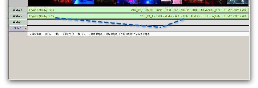

i have a vob file that contain 2 audio stream and one video stream.
2 audio stream : 1--> 2ch stereo , 2---> 6ch (AC3)
when i play this vob file everything is ok.

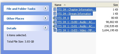

DVDDECRYPTER:
Like anytime I used “dvd decrypter” and demux main vob to 3 files (Big Vob , 2 audio stream)
But result was strange.
The big vob file was smaller than I though .
After play the vob (without audio) I found out the dvd decrypter not extract all chapters!!!

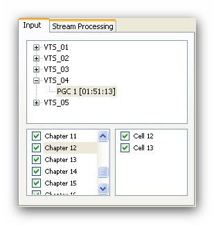

Then I decided extract and demux every chapter one bye one.
Result : when I choose the chapter #13 , the program just extract about half of chapter!!
And another strage thing that is chapter 12 have 2 cells

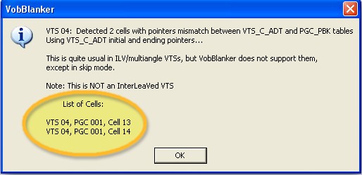

VOBBLANKER:

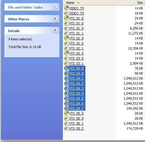

Then I try vobblanker and then choose Video_Ts then I saw this page
I did the full scan but no better result.

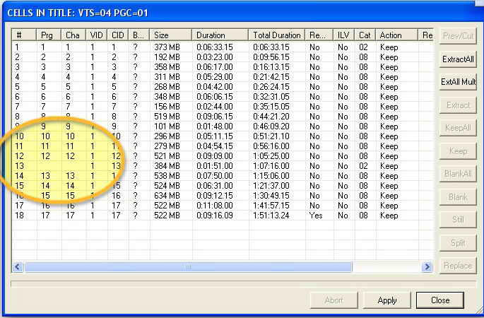

Then I went go to the main movie section and see this strage page
All chapter until #14 is good but when I choose #14 (Chapter 13) it extract just a small vob (165 mb , 2.56min) like dvd decryptor while this chapter is 538 mb and 7:50min
And there was another strange thing.
This dvd have 17 chapters
And there are #18
And when I extract #17 & #18 , they are same !!!!

There's nothing strange about that. The DVD has 17 chapters but 18 cells. Chapter 12 consists of 2 cells. I think this is probably related to the layer break, but I'm not positive.And another strage thing that is chapter 12 have 2 cells

and the other way and easy way : size of files
i have 6.18 gb for this concert (without backstage) and that files the program demux is 3.83gb.
for not confusing you , better i tell you i get realy a dvd folder on the HDD.and please do not tell about bad sector or damage media.
and for using for dvd decrypter i make a image of DVD with Nero and mount it with virtual drive. -

I think I already answered that one. There are 17 chapters and 18 cells (and apparently one of them is a repeat), with Chapter 12 consisting of 2 cells. That's not at all unusual. I'm glad you're making progress finally.Originally Posted by p_samimi
What I don't quite understand is why the chapter 17 is almost the same as chapter 16 and why it's being reused. Maybe it gets used in the extra, but I'd have to have the DVD to try and figure it out. Others with more knowledge than I might be able to figure it out from the pics you provided. -
infact they are exatly same (do not look at time)chapter 17 is almost the same as chapter 16
when i extract both of them and then play them , they are same.
i know this chapter not use for extra, cause extra have a seperate vobs (2 vobs) that not navigate to this file.Maybe it gets used in the extra
VTS_05_1.VOB
VTS_05_2.VOB

HI ,
i have two news.
good news : we did it and i make 2 dvds with menu and backstage and sound and everything.
bad news : second audio stream that show as a 5.1 (dolby) did not have any sound from center and rear speakers.
infact i do not have 5.1 speaker for my pc and after authoring and burn on dvd i tested it on my home theater.
i have not any sound from center and rear speaker when i choose this audio stream !!!!
i test my home theater with another movie and everything is allright.
when i choose this stream the lights of 5.1 on the digital panel of my player going on and show "3.2/1 dolby" but no sound !!!!! (just i have sound from two front speakers)
is it realy 5.1 or not.
Did the original DVD's audio play with sound from the 5 speakers? And with different instruments coming from different speakers for a real surround effect? Maybe the original source audio was really stereo and it was duplicated for the other channels. If so, there's not really much point to keeping the DD 5.1 audio. Maybe there are 5 channels but 3 of them are silent/empty. DGIndex will give you back exactly what the audio is. It doesn't change anything. It does, however, sound like there may be something strange about this audio, if demuxing using other methods produced speeded up audio. Maybe the audio engineers for this DVD were incompetent fools. I've seen it before
You could try and open the VOBs in BeSweet and make 6 mono WAV files to see what's in the individual channels. -
tnxxx man.
you are genius.
i extract 6 wav and funny result.
i have sound just from FL & FR.
rest of them are silent !!!!!!
i think you are right.who was author this dvd was fool.
i was suffer all this difficulty for keep this 5.1 audio stream !!!!!!!
