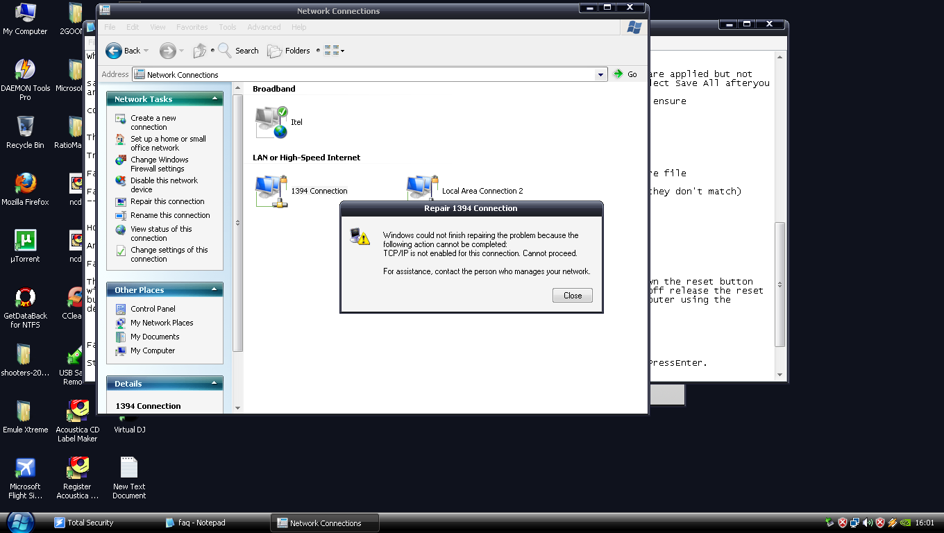

Hi mate,
On the itel thing i dont actually get an option to repair.
I get a status option and an option to set the connection as default. I deliberately didnt default it though as i tohught it was that preventing me from accessing the internet.
The 'Broadband Connection 2' cant be made as default for some reason but however, i can repair that one but sitll get no internet working
