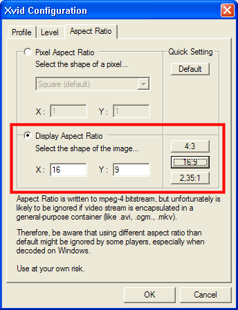

    Thx Jagabo. It is solved. When you talked about Square pixel i chequed the advanced settings within Videostudio. Befor i made the mpeg i saw that there was a option chequed: Non square pixel rendering. This unchequed and the mpg was playing full screen.....

  20. 5:4 is the storage aspect ratio (SAR), the relative dimensions of the frame size: 720/576 = 5/4. If you used square pixel encoding then the SAR = DAR (display aspect ratio). When displayed on a 16:9 TV this should have black pillarbox bars left and right. Even on a 4:3 TV it will have small pillarbox bars.
    To create a 16:9 DAR (display aspect ratio) in an Xvid file you need to either resize the frame to a 16:9 ratio (eg, ~720x400, 512x288) or set the 16:9 DAR/PAR flags in the Xvid codec.
    As mentioned earlier, not all players will respect the DAR flag. So a 720x576 Xvid AVI encoded with the 16:9 DAR flag may continue to display as 5:4.

  22. Your player played my 16:9 DAR flagged video with the correct aspect ratio so we know your player supports PAR/DAR flags.

    When i look at the settings you mention:
    I had set the PIXEL Aspect Ratio to 16:9 PAL. Thought that was the one i needed...

  26. Both Pixel AR 16:9 PAL and DAR 16:9 should have worked.
