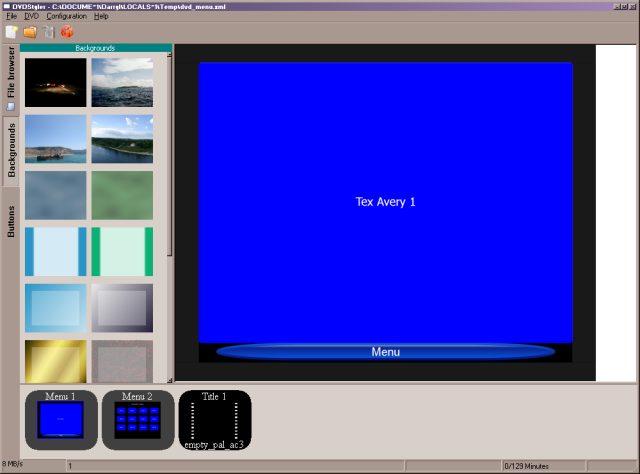

I can confirm this through the log file. The log file also says that executing DVDStyler with this file worked. The result you should see on your computer I have snapshot below:
Note that if Rapid Menu Writer worked, you wouldn't see this window for very long. Also note that Menu 1 in DVDStyler appears to have only 1 big blue button called "Tex Avery 1". Don't be concerned. This menu isn't used in the final DVD. The second menu (Menu 2) is used (the one with the 12 small blue buttons).

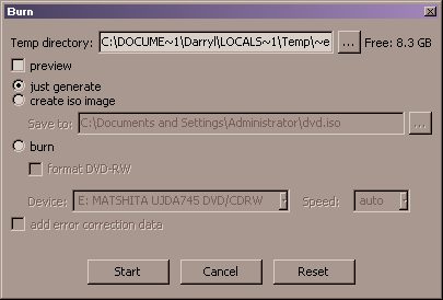

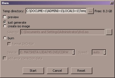

The log file then tells me that F9 was pressed which should have opened the Burn window in DVDStyler. Here a screenshot of the Burn window immediately after it is opened on my computer:
All good so far. At this point something goes wrong. Rapid Menu Writer is now looking for a window titled Burn. For some reason it can't find this window on your computer. Perhaps the Burn window isn't open? I think it is open though, because you are saying that it is choosing "the dvd-out as the path instead of dvd". I get the feeling you are reading this information from the Burn window. Is that correct? If so, it is very strange that RMW crashes here.
Note that at this point (when the Burn window is first opened) you will be seeing old text in the Temp directory field. This is because RMW hasn't yet recognised the window to populate it with the new text. This is probably why you are still seeing "dvd-out" at this point.
I'll describe what should happen next. RMW should see the Burn window, and log the following:
Waiting for the "Burn" window. Result = 1
Activating the "Burn" window. Result = 1
Setting the text of the "Burn" window "Temp directory" field. Result = 1
Clicking "Burn" window "just generate" button. Result = 1
At this point the Burn window should look like this (with the correct Temp directory text):
The log file tells me that the Temp Directory field should have now had the text:
C:\DOCUME~1\Darryl\LOCALS~1\Temp\~ekhaoko.tmp
The log file would then add:
Clicking "Burn" window "Start" button. Result = 1
and the Burn window should close, and the Generate DVD window opens. RMW then continues through the Generate DVD window, closing it when it's finished, and closing DVDStyler, and moving onto PgcEdit.
So in summary, RMW is not finding your Burn window. This is wierd, and I haven't experienced this problem before, or heard of anyone else with this problem yet. As a workaround, try pressing F9 yourself to open the Burn window in DVDStyler (if it's not already open). Once you do that RMW should continue. If it doesn't, then we've got a real issue here. If RMW is not able to find your Burn window when it "is" displayed then it's a serious bug. As I say, I haven't encountered this before. The AutoIT language that RMW is written in is quite robust in my experience, and I haven't yet seen a case when it cannot find a window, such as this one.

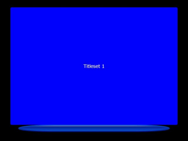

VLC doesn't accurately play a RMW menu (unfortunately). I mentioned this in the RMW help file on the System requirements page. I just tried myself on the same 12 title/button example used in the help file, and this is what I end up with:Originally Posted by dphirschler
I think this is also what you are seeing. For some reason VLC doesn't read the first PGC command of the DVD, which would tell it to open the second menu (with the 12 buttons), rather than the first (with 1 big button). This seems to be a failing with VLC.

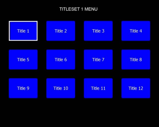

The most accurate free DVD player I've found to date is Media Player Classic Home Cinema (mpc-hc.sourceforge.net). Download yourself a copy of this. It's very good. Use the File -> Open DVD menu item and select the VIDEO_TS folder of your DVD, and you should get something like this:

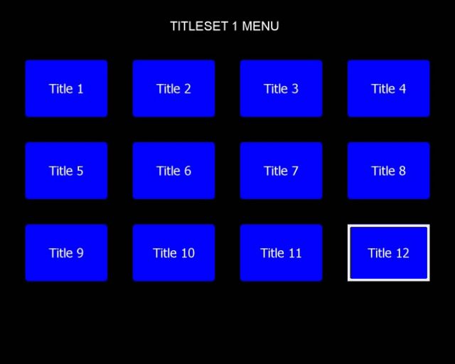

A hardware DVD player will display the menu exactly like this. Move your mouse over the buttons and the highlight changes. In my example, Title 12 is a video of some sand dunes, and Title 11 is a video of a leopard. If I click Title 12 like so:
I get the sand dunes video:
Then the menu is displayed again (because Title 12 is the last video of the DVD).

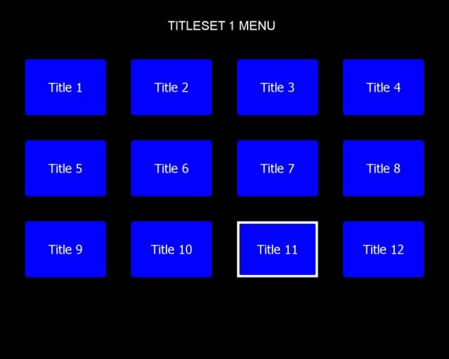

If I select Title 11 like this:
I get the leopard video, followed by the sand dunes video:
Then the menu is displayed again (because again it has played the last video - Title12).

I hit 'OK' and it just sits there in DVD Styler with a menu just like the one you showed above in this post https://forum.videohelp.com/topic372158-30.html#2008719. It's empty with "Tex Avery-1" text and a "menu" button at the bottom. PgcEdit is still open as well. But clearly RMV is waiting for something. It still says "Writing the DVD menu" with 'back', 'next', and 'cancel' buttons, none of which do anything. I had to "end process" to stop it.
