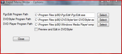

Yes I too believe it's a path issue. I wrote RMW to default to "C:\Program Files\DVDStyler\bin\DVDStyler.exe" for DVDStyler, and "C:\Program Files\PgcEdit\PgcEdit.exe" for PgcEdit. What I will do in version 0.6 is default them to AutoIT's macro for the Program Files directory (@ProgramFilesDir). This "may" work, though without a 64-bit Windows to test it on, I won't know until someone tries it. Reading the news and forums for AutoIT, there have been issues in the past with 64-bit support. I am using version 3.2.12.0 of AutoIT (2008). It's not the latest, and perhaps better 64-bit support is in v3.3.Originally Posted by Ai Haibara
What's really confusing me is that mail2tom can't get to the Options window, because the error message is blocking him. This can't happen in my code, because this error message is only generated after the user clicks "Next" from the Welcome page of the tool. While on the Welcome page, it should be possible to click the Tools menu, then Options. At least it works for me on Win XP. Maybe the Options window isn't opening for mail2tom due to a Win 64-bit bug in AutoIT. I really need the log file from mail2tom to see what events transpired. -

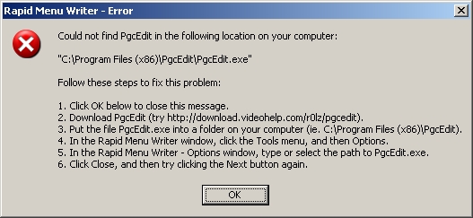

I have attached a new version of the "Rapid Menu Writer.exe" file to this reply. Can you copy it to your "C:\Program Files (x86)\Rapid Menu Writer" folder. Also delete the file "C:\Program Files (x86)\Rapid Menu Writer\data\Rapid Menu Writer.ini", and try running the program again.Originally Posted by mail2tom
I have created this file specifically for you (as a Windows 64-bit version), and the difference is that it defaults PgcEdit and DVDStyler to the path "C:\Program Files (x86)\PgcEdit\PgcEdit.exe" and "C:\Program Files (x86)\DVDStyler\bin\DVDStyler.exe". This will hopefully avoid the error message you are getting.
I also improved the error messages to include the path it is looking for.

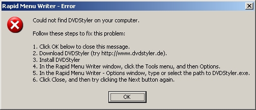

Copied your new RMW executable to C:\Program Files (x86) and ran it, but got an error about PGCEdit not being in C:\Program Files (x86).
Once I moved it over, the program seemed to run properly under XP64, so I also installed it under Vista64 Ultimate.
I setup a session to produce a menu under XP64, which crashed the computer. (I couldn't find the error in EventViewer.)
I setup a session to produce a menu under Vista64 Ultimate and the program stalled with PGCEdit and RMW on screen with RMW displaying "Writing the DVD menu" which never completed. I had to kill the process.

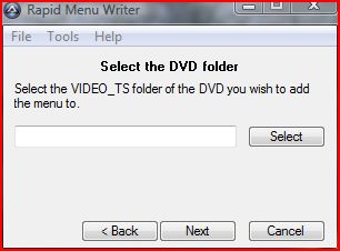

Well, it seems to be working, so far. I tried starting Rapid Menu Writer without copying the updated EXE, first, and it complained about PGCEdit. After copying, it started without any complaints. I still don't have any DVD projects handy at the moment to throw at it, though.
...and I have no idea why Vista's Snipping Tool capture added those red borders. I'll have to check the options.
