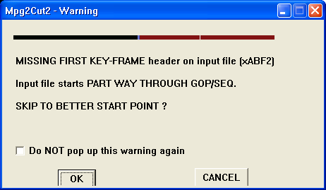

Ideally you could make a single MPEG2 file, but I also tried videoredo, and quickstream fix etc...no luck with the pixellation on those test files. tsmuxer doesn't seem to work on those, even with extension renamed
You should check the HV20 forums, maybe there is a better workflow, because this seems a very convoluted way to get what you want... -
Running each indiviudal file through videoredo's quickstream fix, and then appending them with videoredo seems to work (no pixellation at the cut/join sites). (But appending clips first , and then quickstream fix didn't work). I only have 2 test clips that I copied a few times, so you might want to try it out on a bigger sample. I don't know if videoredo has a batch quickstream fix
You are right, after using VideoReDo quickstream fix's function - the output .mpg files are fine, no pixellation at all.Originally Posted by poisondeathray
There is a batch quickstream fixing, I'll try it tomorrow's morning.
Hehe. So it seems HV20 produces defective files.Originally Posted by jagabo
By the way, thank you very much, poisondeathray, jagabo and manono. You're all being a great help. -
Was the sample file a full clip directly from the camcorder or did you trim from a larger file?
