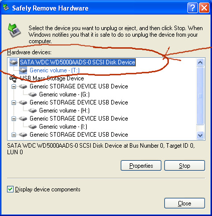

I have an external Sata drive and it is no longer showing in my Safely Remove Hardware list. Only my external USB drives are listed...
I checked my driver's properties and write caching is not enabled...
I must turn on the external drive and reboot my computer for it to be listed. I also turn off my computer when I detach the e-Sata hard drive....
Any thoughts?
Thanks kindly...

eSATA doesn't show as a removable drive on most of my computers. IMO, it shouldn't anyway as it is tied directly to the PCI bus and should act exactly the same as a internal drive. Some MBs do show them as removable, though. I suspect something updated in your system, maybe the OS itself and that changed it. Most people complain when it is listed as removable. This can also happen with internal SATA drives with some MBs and drivers.

I found the answer... Changing in bios my SATA controller to AHCI mode enabled my e-Sata drive to show in the Safe Remove Hardware list...
Apparently some Sata controllers can be run in several modes including Raid, AHCI, IDE compatible and Sata...
Putting your Sata controller into AHCI mode enables the hot swappable option....
AHCI enables hot swapping for SATA drives and also includes native command queuing.

I AHCI is only required if you want to make your SATA drive hot swappable...otherwise ide or RAID is fine...
