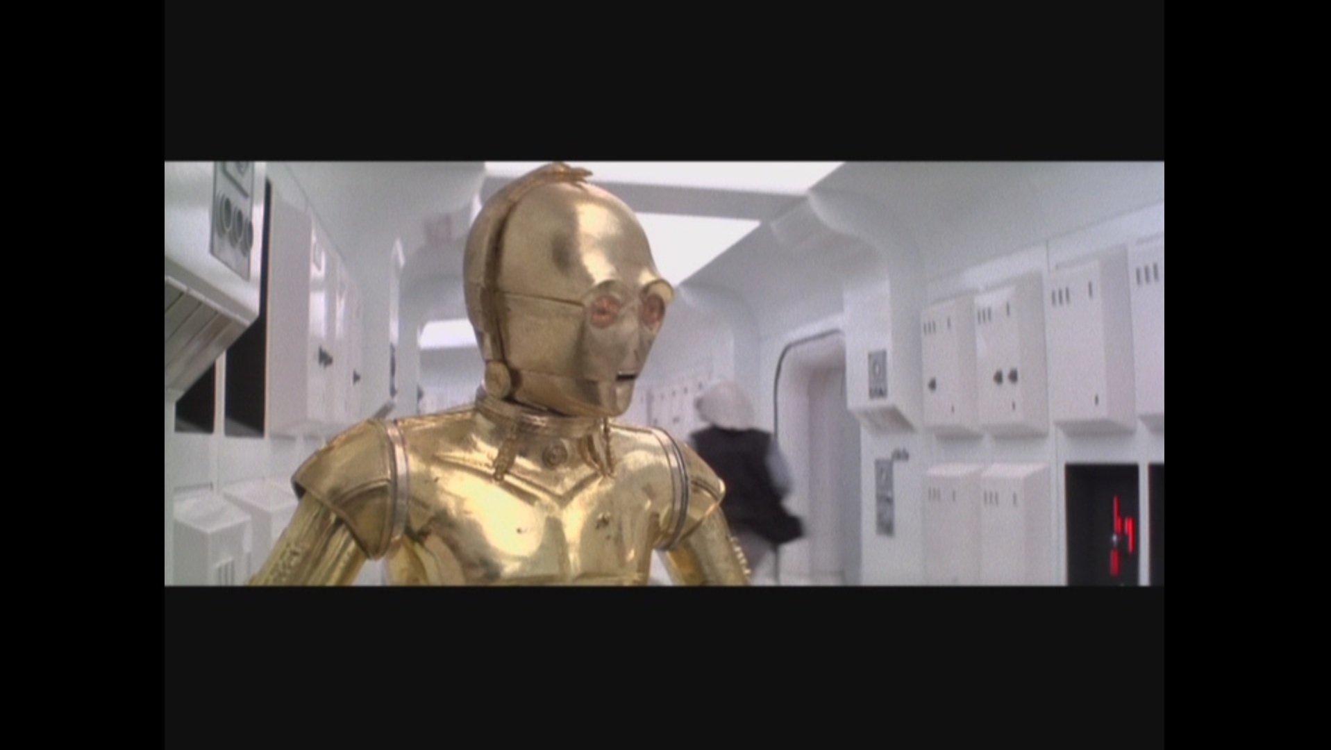

    heres a 1 sec clip
    vts_03_1.demuxed.m2v
    play with mpc home cinema or something. when you go full screen it doesnt stretch across the entire screen(huge black boarder) it also lets you see the difference in blacks.
    Aug 2009
    here a pic of it full screen on my computer

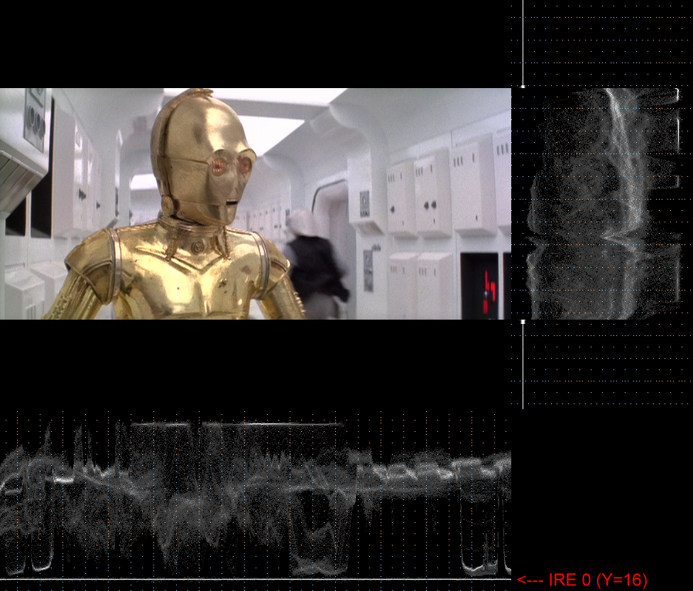

  3. Thanks much for the clip. I wanted the demuxed M2V file so I could see the video without being processed by whatever you're using to take snapshots. As I suspected the black borders are at the correct level in the M2V -- IRE 0 (Y=16).
    There is something wrong with your processing or your computer/DVD/HDTV setup. A proper display should look like the above image. Note the blacker blacks and brighter brights. Fixing the display of black level for the borders will also fix it for the picture.
    Note that you can get the proper display on your computer with DgIndex by selecting: Video -> YUV to RGB -> PC Scale. This only effects what DgIndex displays, not the video that's served to AviSynth.
