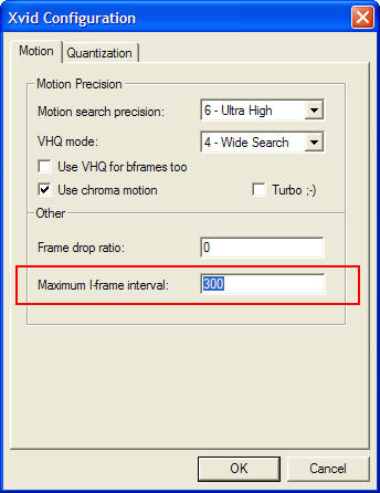

Virtually all encoders can set min/max keyframe interval. The settings are usually in the options. For a 29.97fps video, that's 1 keyframe per 30 if you want them 1sec

xvid, divx, x264, HCenc....In fact, I can't think of one that doesn't You just haven't looked in the options, or the GUI's you've used are too simple to allow you to access those options. If you set the max key interval (it might be called I-frame interval or similar terminology) to 30, the highest will be 1sec apart, it might be closer together, unless you set the min interval. If min=max you get the exact placement setting. If you set min=max=1 , they are all keyframes. Note compression efficiency decreases with shorter intervals
Here is an example in the xvid vfw interface (what you would see if you used vdub). The xvid defaults are 300, so that would be ~10sec for a 29.97fps video. Note that is the maximum, it still dynamically places them, so they could be shorter intervals.
thanks for the info. I never realized that, or like you said never found it. those things you mentioned though, like xvid, divx, x264, HCenc, aren't they all codecs? That means I would still have to look for a program like VD or can I use these with vd? how can i get into the configurations of xvid like you showed in your post?
