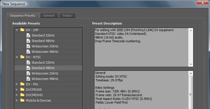

I assume you are using a DV project setting. Is this true? How are you capturing? What hardware?Originally Posted by Priapism
Does the video look OK when viewed from the timeline? How are you monitoring?
Best way is to monitor off the IEEE-1394 port through a camcorder analog output to a TV.
Some MPeg settings issues:
Target bitrate has the greatest effect on quality. VHS is noisy. Noise makes motion detection more difficult causing quality to drop at higher compression. Solution is to reduce noise or raise target bit rate. If file size is a concern, you can lower resolution to 352x480 and use 4-5Mb/s.
Why progressive? VHS is 480i. Deinterlace will lower quality especially from a noisy source. You should encode interlace and let the DVD player or TV deinterlace if necessary.
If the recorded material is telecined film, it is possible to extract the 23.976p frames using inverse telecine (IVTC).

It looks like MS DVD Maker always recodes so if you want to use it, export files from CS4 as DV-AVI format then import into DVD Maker.
Normal workflow is to encode to DVD legal MPeg2 in CS4 then import the MPeg2 files into the DVD authoring program as assets. The authoring program should be set to not encode compliant assets.
To encode interlace MPeg2 in CS4 set the encoder for lower field first for a DV project or upper field first for HDV or uncompressed.Recommends: Kiva.org - Loans that change lives.

Just out of curiosity - when starting this entire process, which setting do I want for this type of video? (old school VHS circa 1998).
