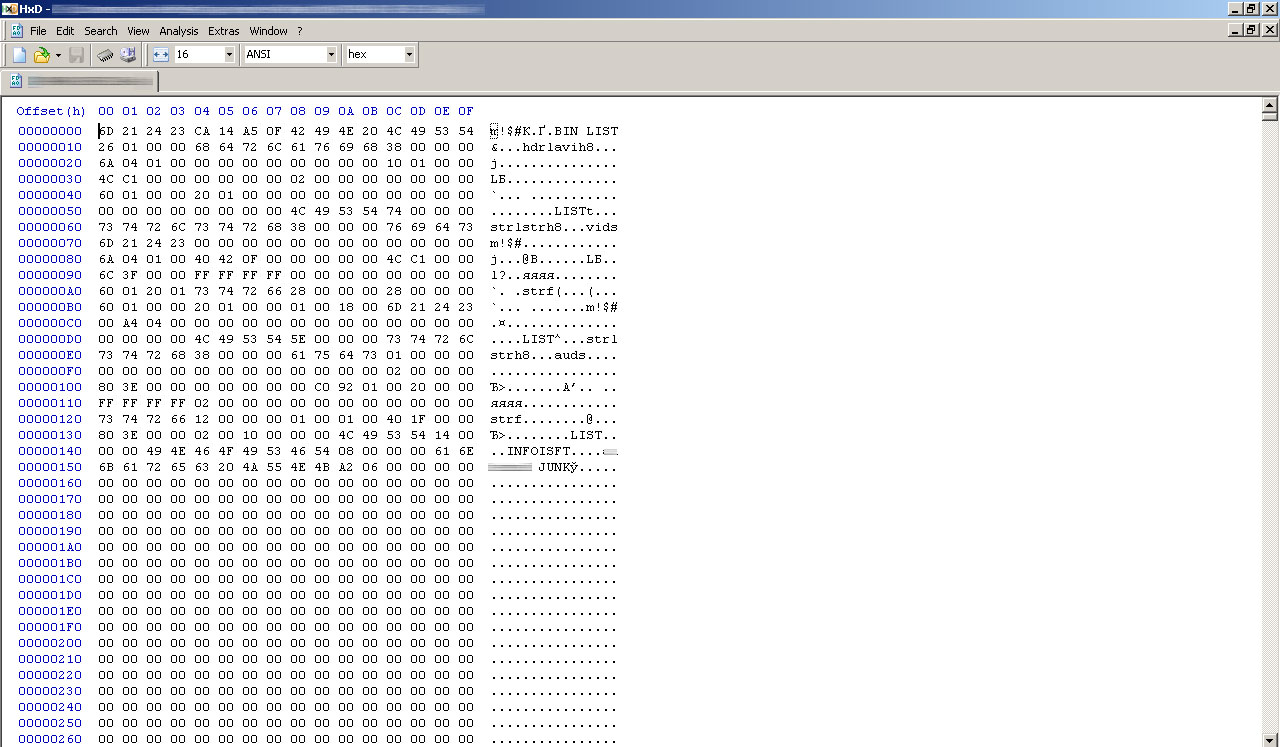

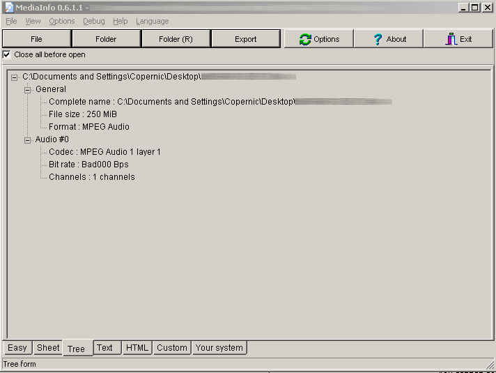

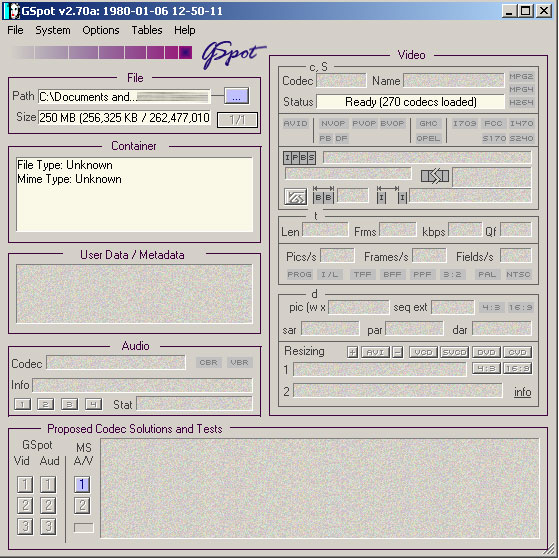

Hello, I'm trying to play avi file but without success, all players that I have tested didn't want to play this file type, here is the report from AVInaptic:

[ Hex dump ]
00000000: 6d 21 24 23 ca 14 a5 0f 42 49 4e 20 4c 49 53 54 |m!$#К.Ґ.BIN LIST|
00000010: 26 01 00 00 68 64 72 6c 61 76 69 68 38 00 00 00 |&...hdrlavih8...|
00000020: 6a 04 01 00 00 00 00 00 00 00 00 00 10 01 00 00 |j...............|
00000030: 4c c1 00 00 00 00 00 00 02 00 00 00 00 00 00 00 |LБ..............|
00000040: 60 01 00 00 20 01 00 00 00 00 00 00 00 00 00 00 |`... ...........|
00000050: 00 00 00 00 00 00 00 00 4c 49 53 54 74 00 00 00 |........LISTt...|
00000060: 73 74 72 6c 73 74 72 68 38 00 00 00 76 69 64 73 |strlstrh8...vids|
00000070: 6d 21 24 23 00 00 00 00 00 00 00 00 00 00 00 00 |m!$#............|
00000080: 6a 04 01 00 40 42 0f 00 00 00 00 00 4c c1 00 00 |j...@B......LБ..|
00000090: 6c 3f 00 00 ff ff ff ff 00 00 00 00 00 00 00 00 |l?..яяяя........|
This report was created by AVInaptic (18-11-2007) on 14 ago 2009, h 10:50:25
It's encrypted or damaged?
I can't found nothing about this file type, please help
sorry for bad English

It corrupt alright! The first 4 characters in an AVI file are always "RIFF"...the LIST chunk at position 000C in the hex dump usually exists at position 0058 (try HXD on a working AVI for comparision)
Looks like something has clobbered the first 80 or so bytes in the file...as a WILD attempt at recovery, copy the first part from a working AVI (up to the LIST chunk) and append the LIST chunk onward from your corrupt file. If you're lucky one player might be able to read it, or try one of the various AVI fixer tools.
Or it's encrypted in same way (as you suggested)...the BIN text just before the LIST section looks suspicious

The file is corrupt as it does not have a valid AVI header.
Remake the AVI from your original DVD. -

Try changing the first four characters to RIFF. Then change the BIN (in the first line) to AVI. The next problem will be the FourCC at 0x00000070 and 0x000000BC. Your file reads m!$#. Unless you have a decoder for that (or can figure out what the decoder it really is) you won't be able to read the data.
